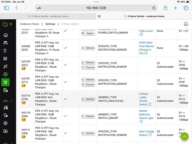

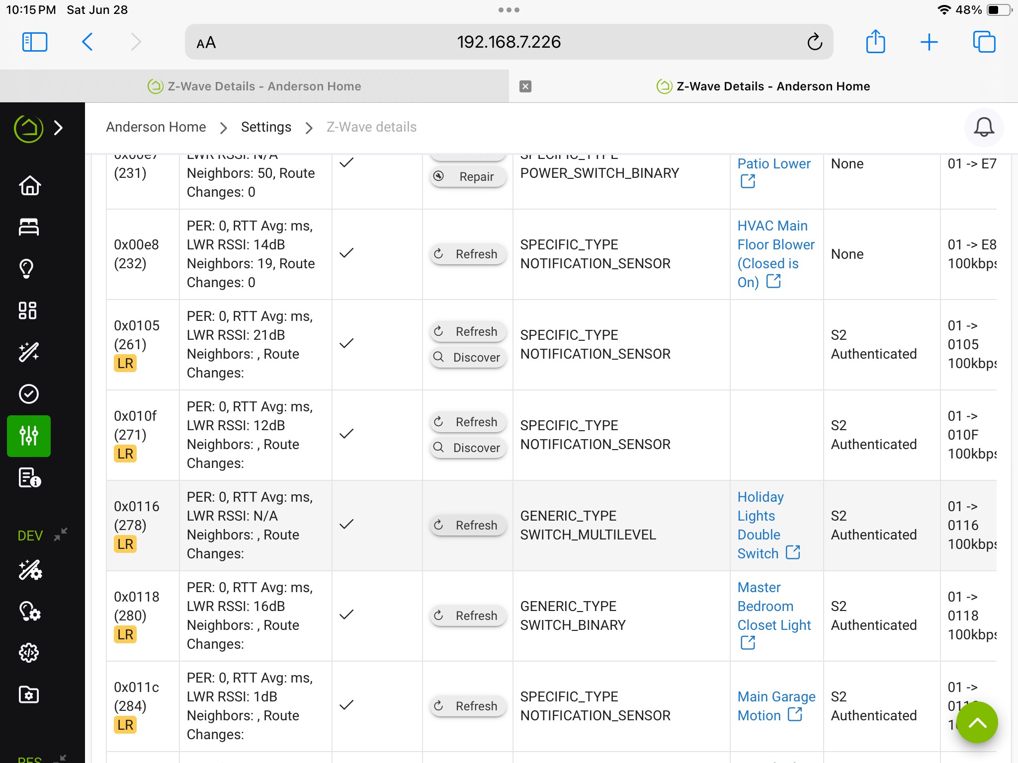

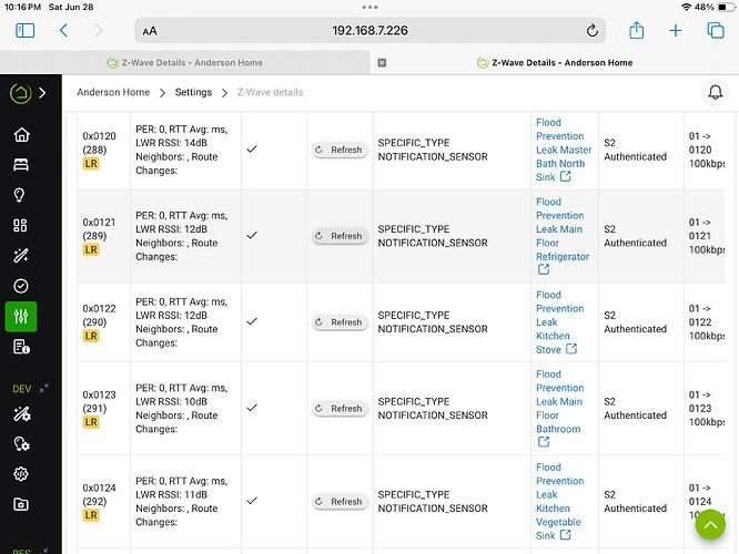

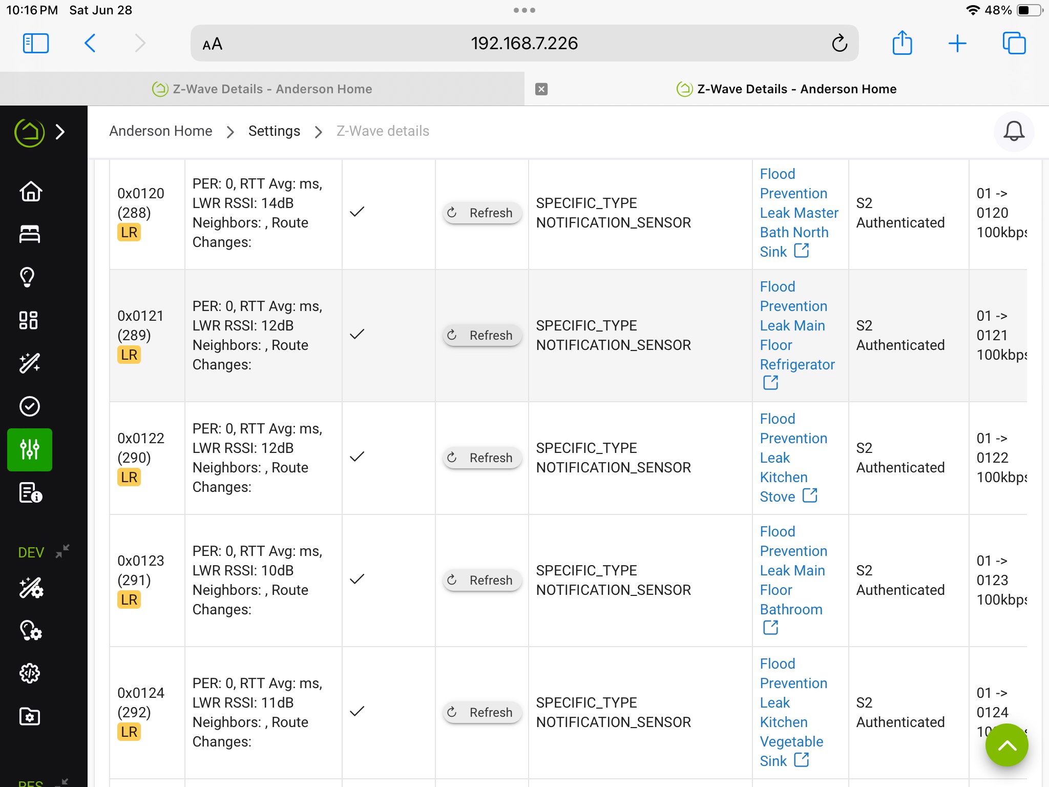

In the morning, there were two LR-Zwave ghost nodes (see attached pic ending in 0260) that popped up. I tried to refresh them, and they actually refreshed (my hope was they would be removed or show a method to remove). I then shutdown the hub per the instructions and restarted the hub.

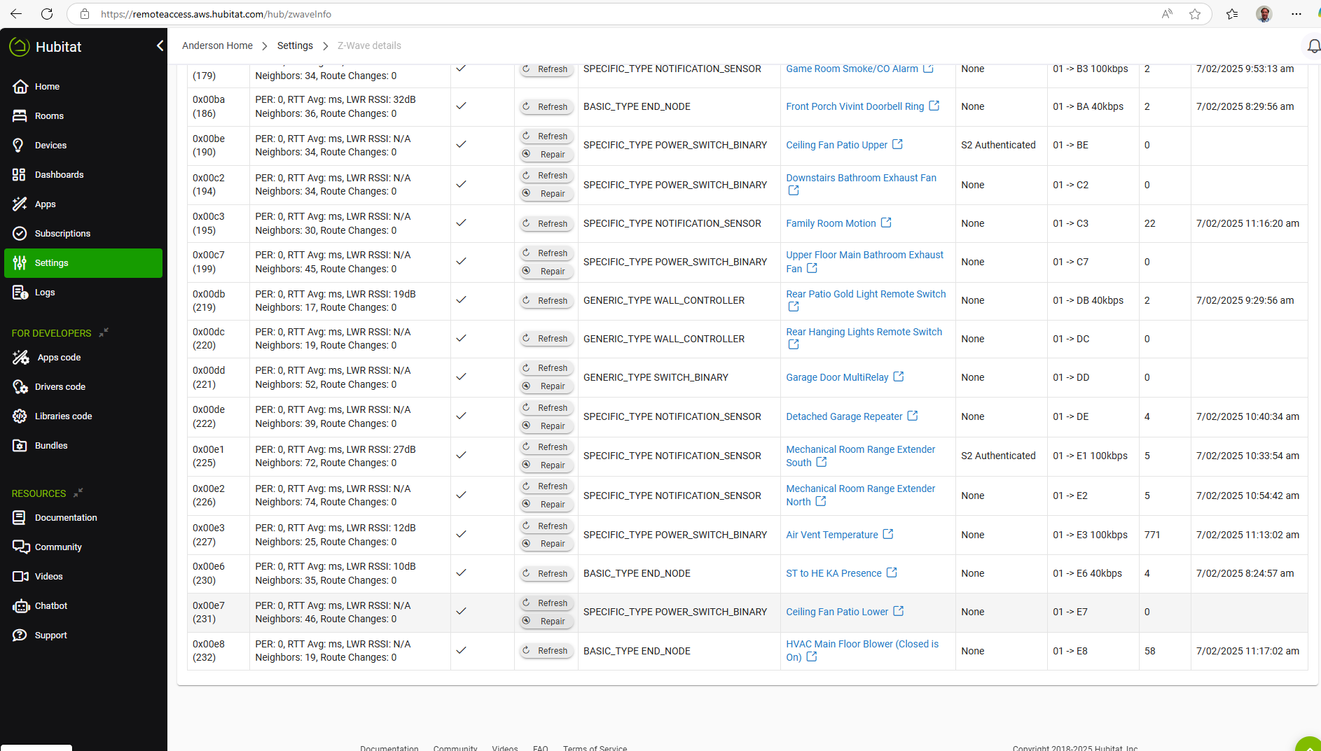

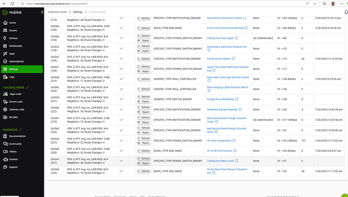

When boot up was finished, the Z-Wave Details page no longer showed the LR-Zwave ghost nodes but it also did not show any of the total 22 LR-Zwave devices (18 Battery, 4 Line Powered). However, the LR-Zwave devices would still function and were listed as Devices.
I also noticed that my Mesh was messed up in that 12 of my battery powered devices now showed as a line-powered devices (had the Repair below the Reset) and 8 of my line-powered devices now showed as battery powered (showed Repair only).
Decided to restore the final cloud back-up that I made when everything looked perfect (used the restore Z-Wave Radio, and file manager selection....I do not have any Zigbee. Unfortunately, this did not change anything on the ZWave Mesh or bring back the view of the LR-Zwave. Tried to do this at least 3 times...no improvement.
I have now worked about 24 total hours Excluding and Re-Including 20 Mesh ZWave devices along with getting them placed back into Webcore Pistons, Dashboards, or other Automation. Everything seems great on the ZWave Mesh.
However, my LR-ZWave devices do not show up on the ZWave details page but all of them work and report.
How do I regain the ability to view my 22 LR-ZWave devices on the ZWave details page.
Pics are shown below.

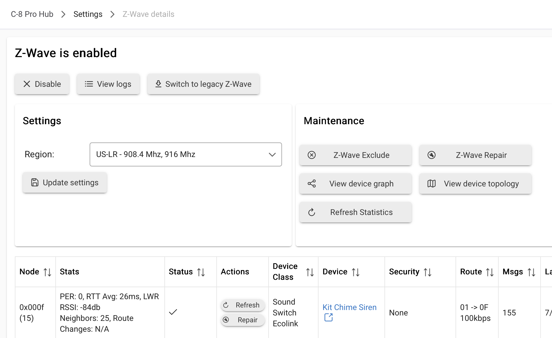

This is what you see with ZWJS enabled:
IIRC, the "Switch to [legacy or js]" button only displays on a C-8 Pro.
Since john022662k has an 8, so I don't think they'll see that button.
Unless they enabled JS via the endpoint (unlikely), they'll be on legacy/zip.
I can't keep it straight, lol.
I could've swore I went back and forth on my C8, but my memory isn't it what it used to be.
