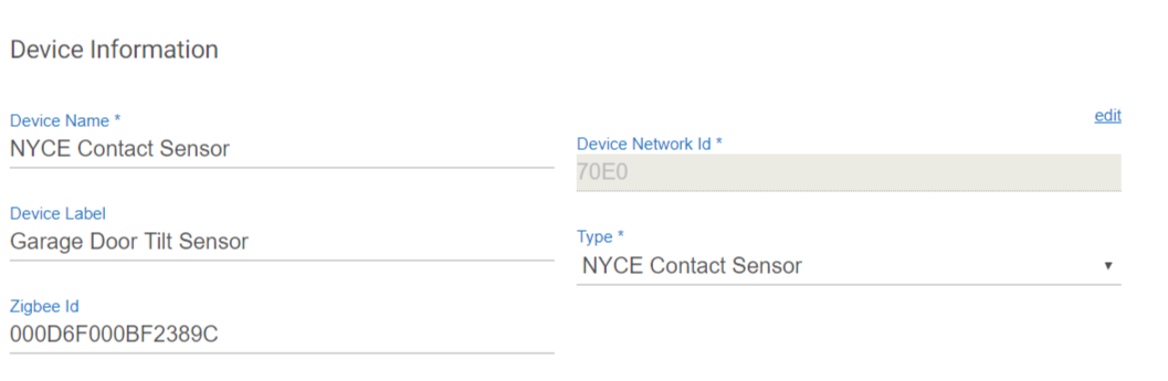

Moving over from iris. I have a NYCE tilt sensor model 3014, that I used on iris to check status of garage door. Open/closed. In discovery Hubitat lists it as a motion detector. I see no option for a tilt sensor. I just want to create a tile that tells me if this device is opened or closed but I see no way to tell it to just give me status I guess because it list it as a motion device. I changed device to contact sensor but no luck
I moved over from Iris last week. I have NYCE tilt sensor for the same purpose. Mine is paired and working correctly. There is a NYCE driver for it and i am pretty sure it was found automatically. Here is a screenshot of the device. Not sure the model though, mine may be different.

Yes. HE found the device and auto paired but listed as motion device. There are it options within the device page that states status of device I will delete and re pair and see if your product id will fix my issue
Make sure to hit "Configure" after you change the driver.

NYCE tilt has no three axis output, the correct driver for it in HE if the NYCE contact sensor.

So here's a (another) suggestion - ignore this if you have already done it - I wasn't sure - you should be able to change the device to the NYCE Contact Sensor as redbo has indicated he is doing. That would seem to be the correct driver since Mike Maxwell has confirmed the Nyce has no angular sensors. You just go to the device page and click where the Type field is, then pick the NYCE Contact Sensor from the drop down list. Save that and make sure to hit configure.
