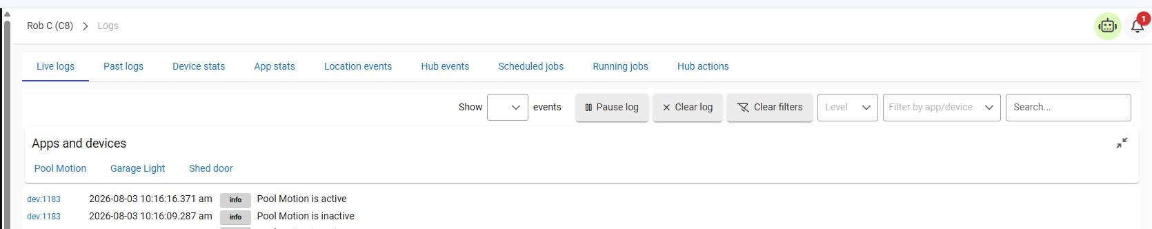

Not sure which log will help as there are so many and I tried to reconnect but no logs showed that but mobile "hubbitat" shows it going through the motions saying connected but during reconnect it hangs. Heres a screen shot of what log options I have.
That’s the right spot. On top, you will notice that you can see “Live logs” and “Past Logs”.
If you know the time you tried to pair the device, you can go to “Past Logs” and see if any are relevant, and if so, post them here the same way.
