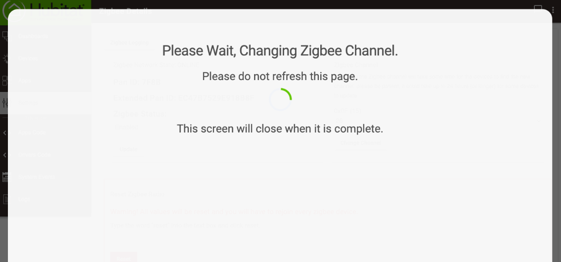

Do you see this screen when changing channels?
