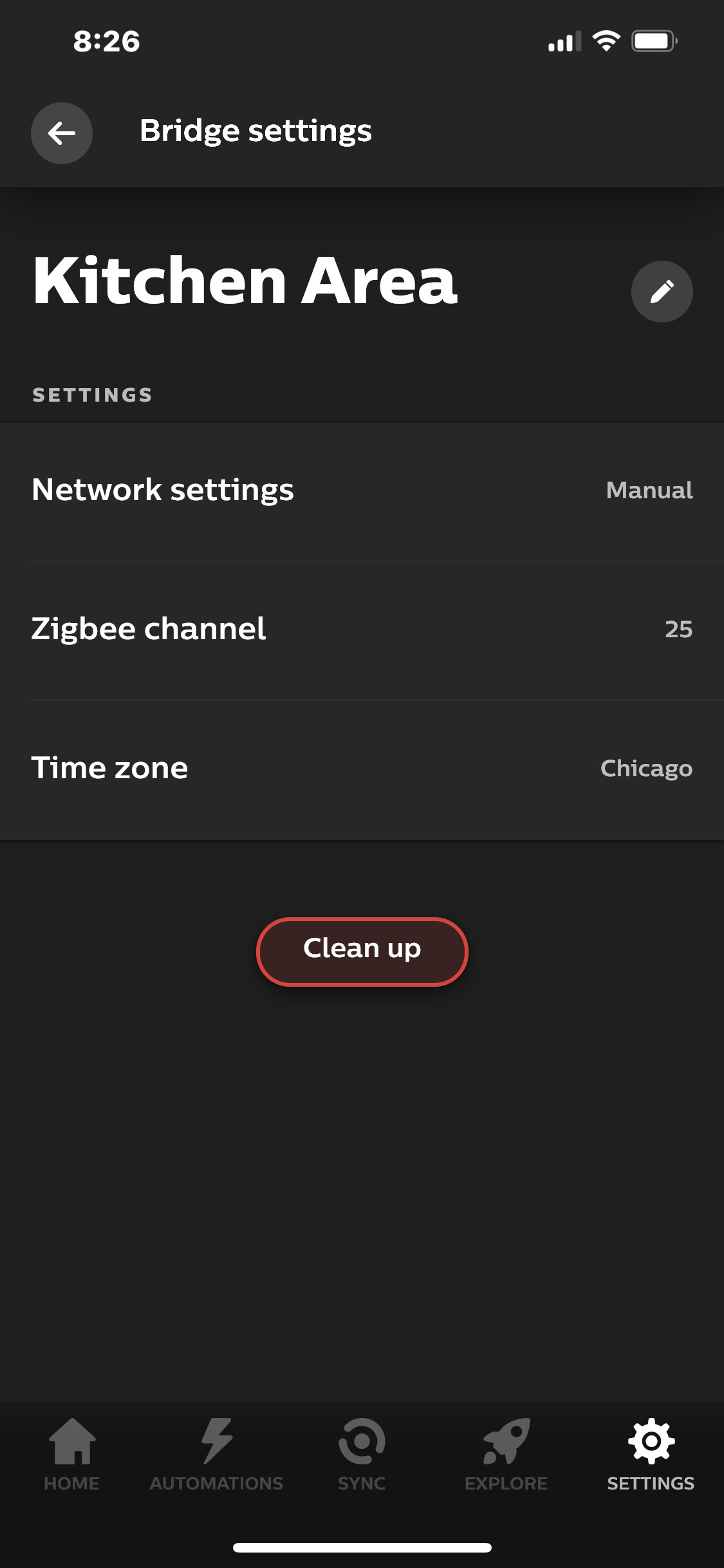

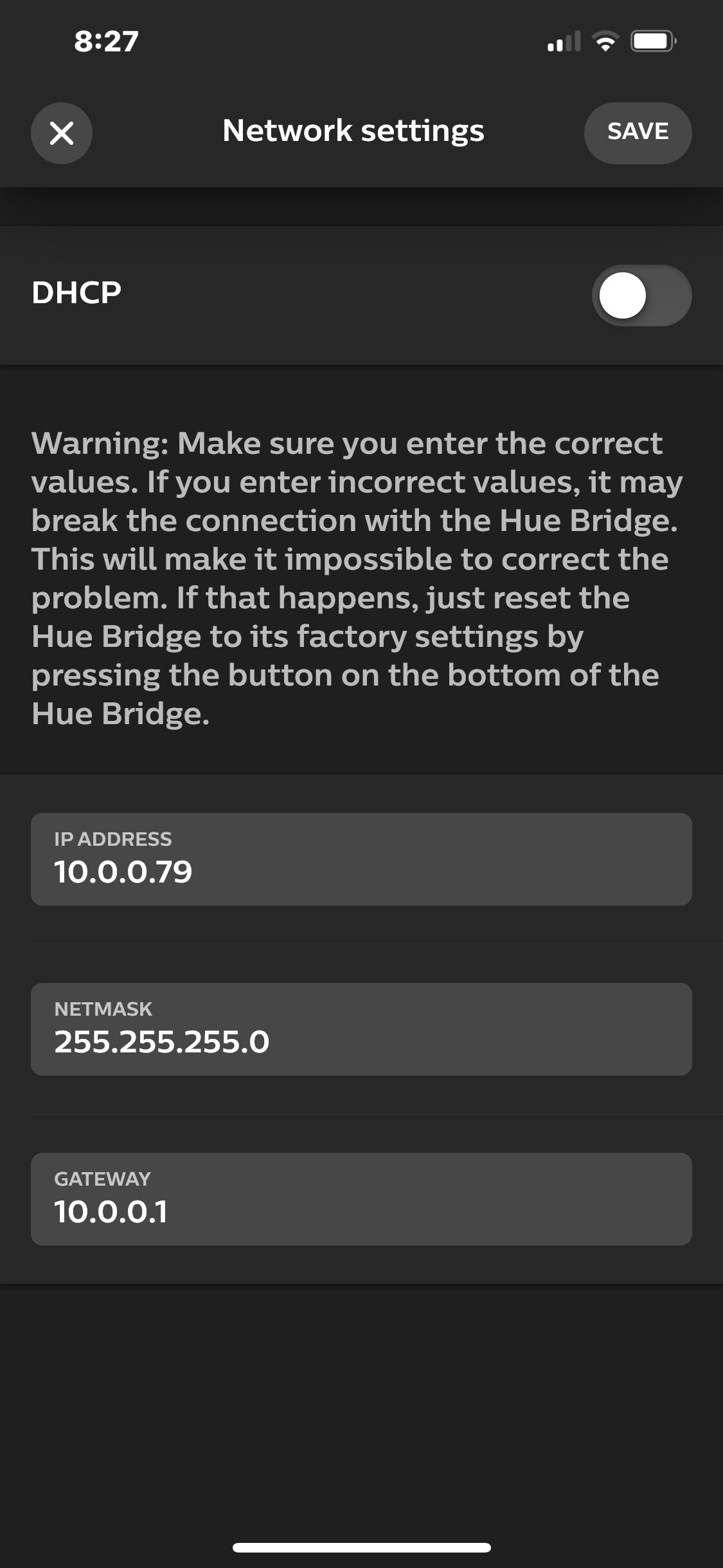

Ok, so in the Philips Hue App, I selected static IP for the bridge in question and I put in the IP address listed in the CoCoHue App instance for this bridge. I also went into my Xfinity router, found that very IP address and made sure to reserve it. I then restarted both my Hubitat and the Philips Hue bridge and…. still no response to any of the devices in my Kitchen to Hubitat commands. But again, I can send commands through the Philips Hue app to the kitchen devices, and I can send commands through Hubitat to any of my other bridges.

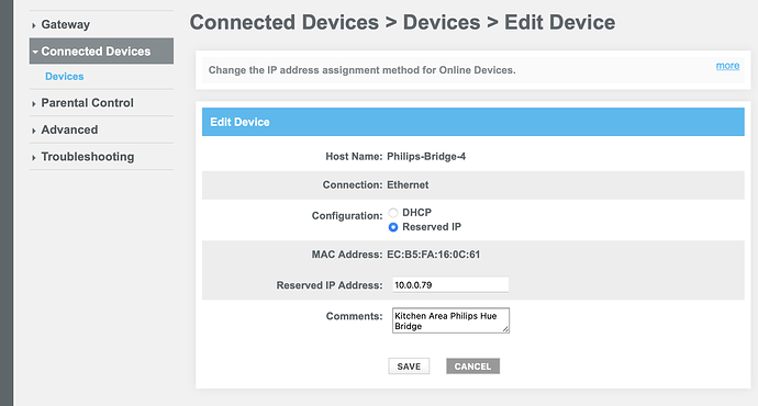

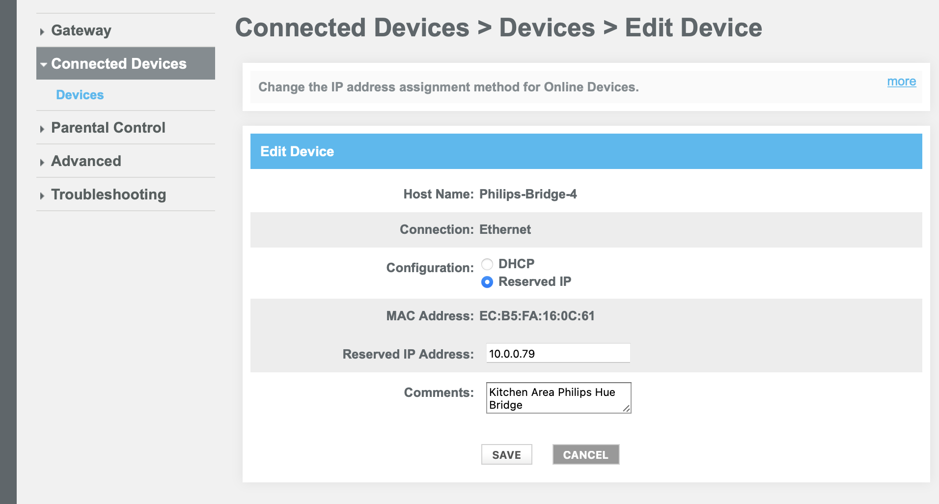

Here is a screenshot of how I "reserve IP addresses" or get static IP or whatever:
The options are either "DHCP" (which is what it is by default) or "Reserved IP" - I don't if the latter means Static IP or Reserve DHCP...

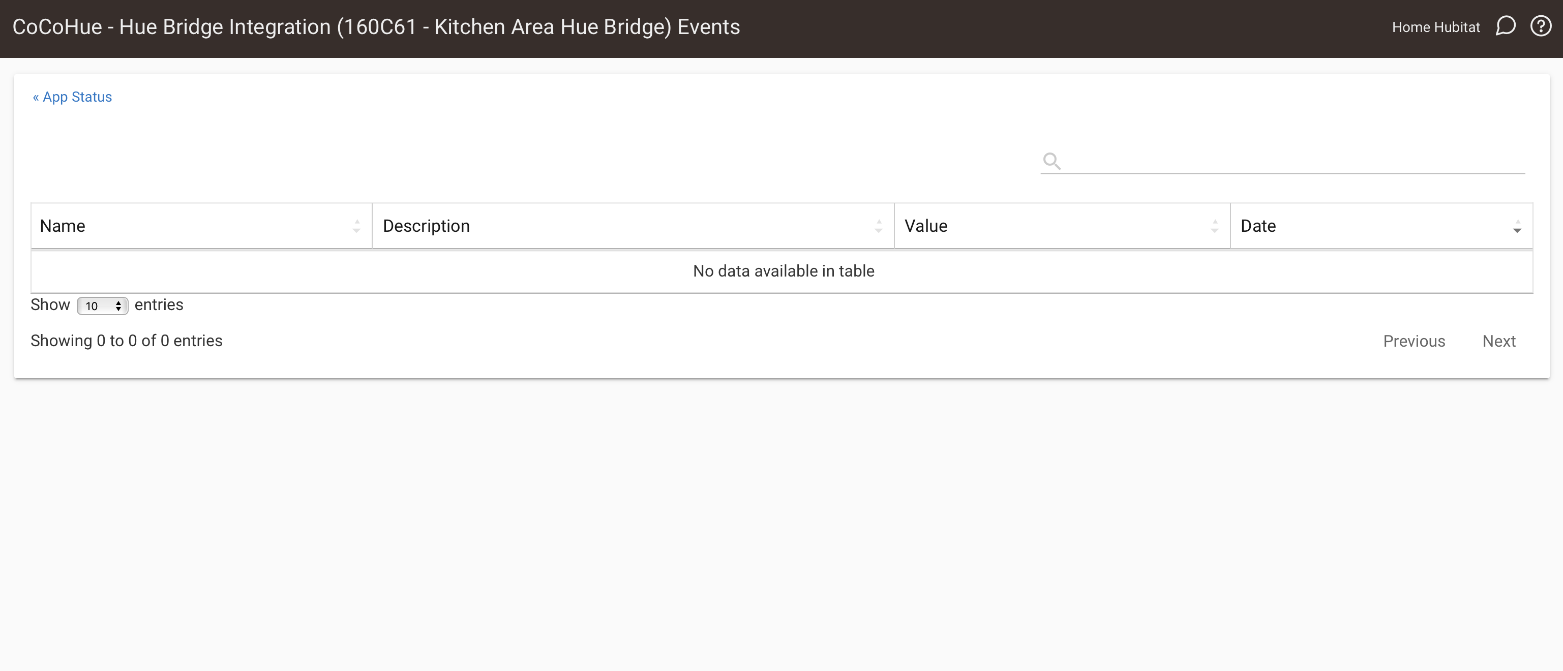

OK, I verified that this bridge has a reserved IP address for 10.0.0.79, and that the Philips Hue App also has this as the IP address, and that this is the same address. I'm sending a command through my dashboard to turn on one of the kitchen scenes and here is what I record in the event log for that CoCoHue App - absolutely nothing:

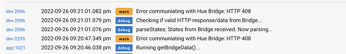

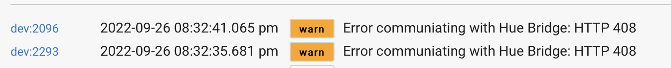

@bertabcd1234 I also went to the Logs section in Hubitat and here I found something interesting:
So it says "error connecting to Hue bridge." Does that tell us anything?

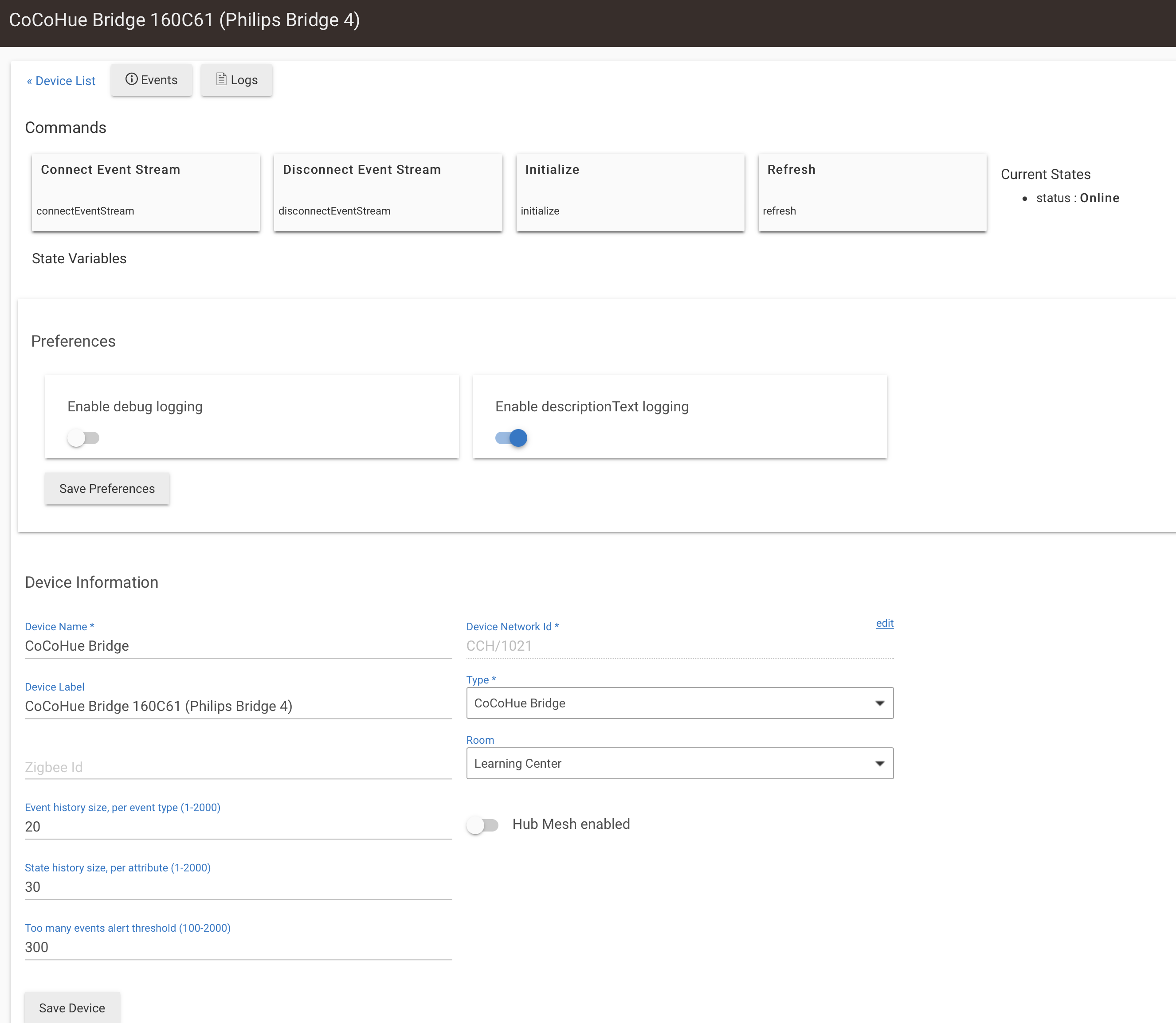

When I clicked on the "warn" button I found something else interesting - it leads me to the App page for this instance of CoCoHue, but it has the OLD NAME (Philips Hue Bridge 4) on the bridge before I renamed it in CoCoHue and in the Philips Hue App to (Kitchen Area). Could that be relevant somehow?
Enable logging for the app and bridges device, and you'll probably see more useful information. HTTP 403 is a timeout, which I could see if it's still trying the old IP. A manual address should eliminate that, but even if you use discovery, it goes by MAC address and not name, so as long as it's the same Bridge, changing the name should have no effect. The app is called whatever call it, which does default to something that includes the (original) bridge name, so also not a concern.

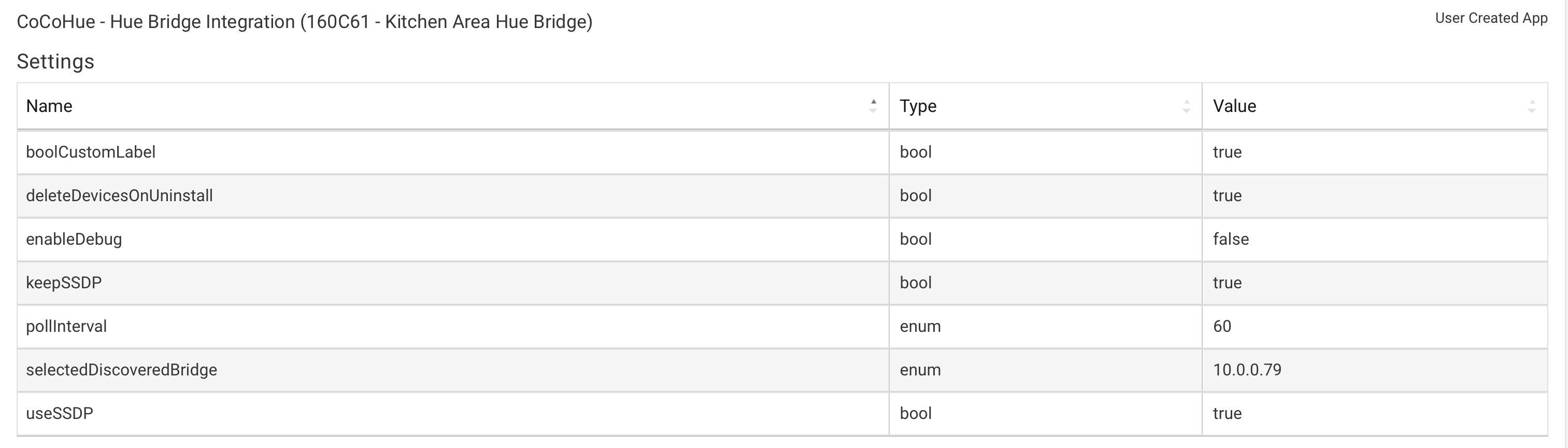

I do this by clicking "enable debug logging" in this particular instance of the CoCoHue App, right? Is there anything else I need to do to do this?
So far after doing that and sending another command, I got only the following in the log: dev:20962022-09-26 08:42:01.080 pmwarnError communiating with Hue Bridge: HTTP 408
Yes, also enable it on the corresponding Bridge in your Devices list. The particular light or group you're using wouldn't hurt, either, though I suspect the problem will appear elsewhere.

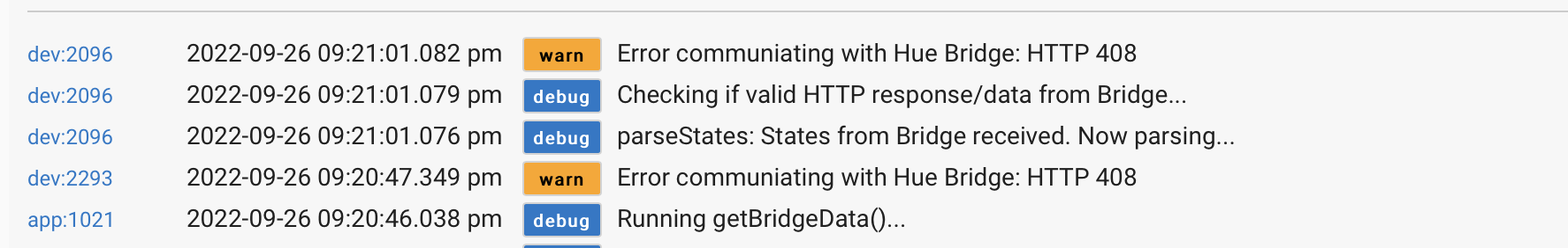

Ok I did both and here is what happened when I sent a command:
Does that help any?

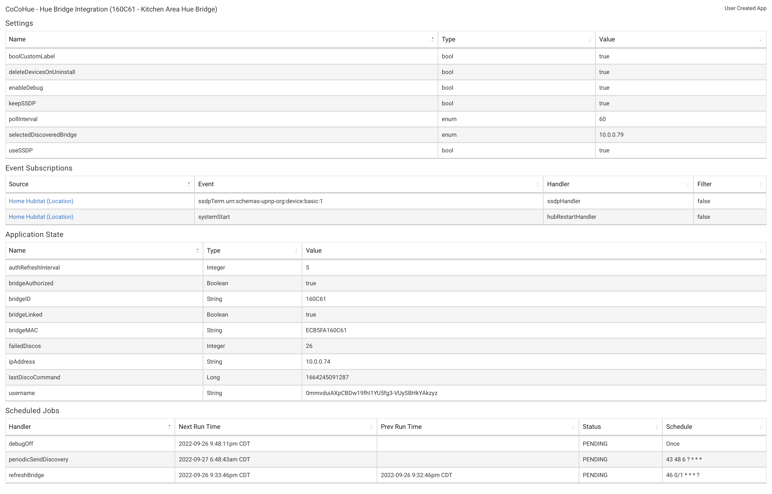

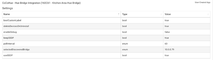

Welp, that wasn't helpful for me, but that appears to be because I don't see a way that enabling logging will spit out what I'm really looking for (though you could get it from App Status, which I don't quite see above--I'd need state, not settings).

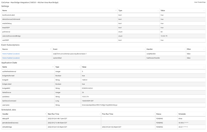

I verified using Hubitat Package Manager that there are no pending updates, so I assume I'm using the latest. You mention App Status - here is what that shows in case that's helpful. If not, I guess I will have to update the App with the code you mentioned. I've definitely hit "done" after upgrading or if not at that time, then definitely at times after that.
