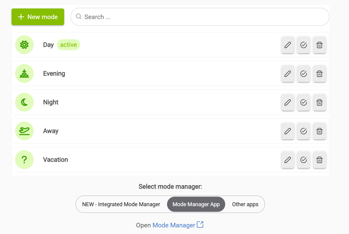

So, I was messing with the Integrated Mode Manager and suddenly, I cannot access the hub anymore either through Remote Access or the leased IP. I tried both a soft reboot and unplug for 1 minute and plugging back in. I'd be able to get back in for 1 to 2 minutes and when I try to get back to the old Mode Manager and undoing everything I did in Integrated Mode Manager, it just starts spinning indefinitely again half way through. My automations are still working, but I can't do anything in the hub page. I thought maybe it was a LAN issue, but I am able to access my router page.

Okay. I managed to get it switched over back to Mode Manager App and deleting all the Integrated Mode Manager setup after painfully restarting the hub like 3 times and doing a little at a time until it starts spinning again. And I am no longer having the issue. I think it has to do with Integrated Mode Manager like I suspected. Note to self: Do not fix what isn't broken even if it has a shiny "NEW" button. Hopefully, they don't deprecate Mode Manager App anytime soon.
