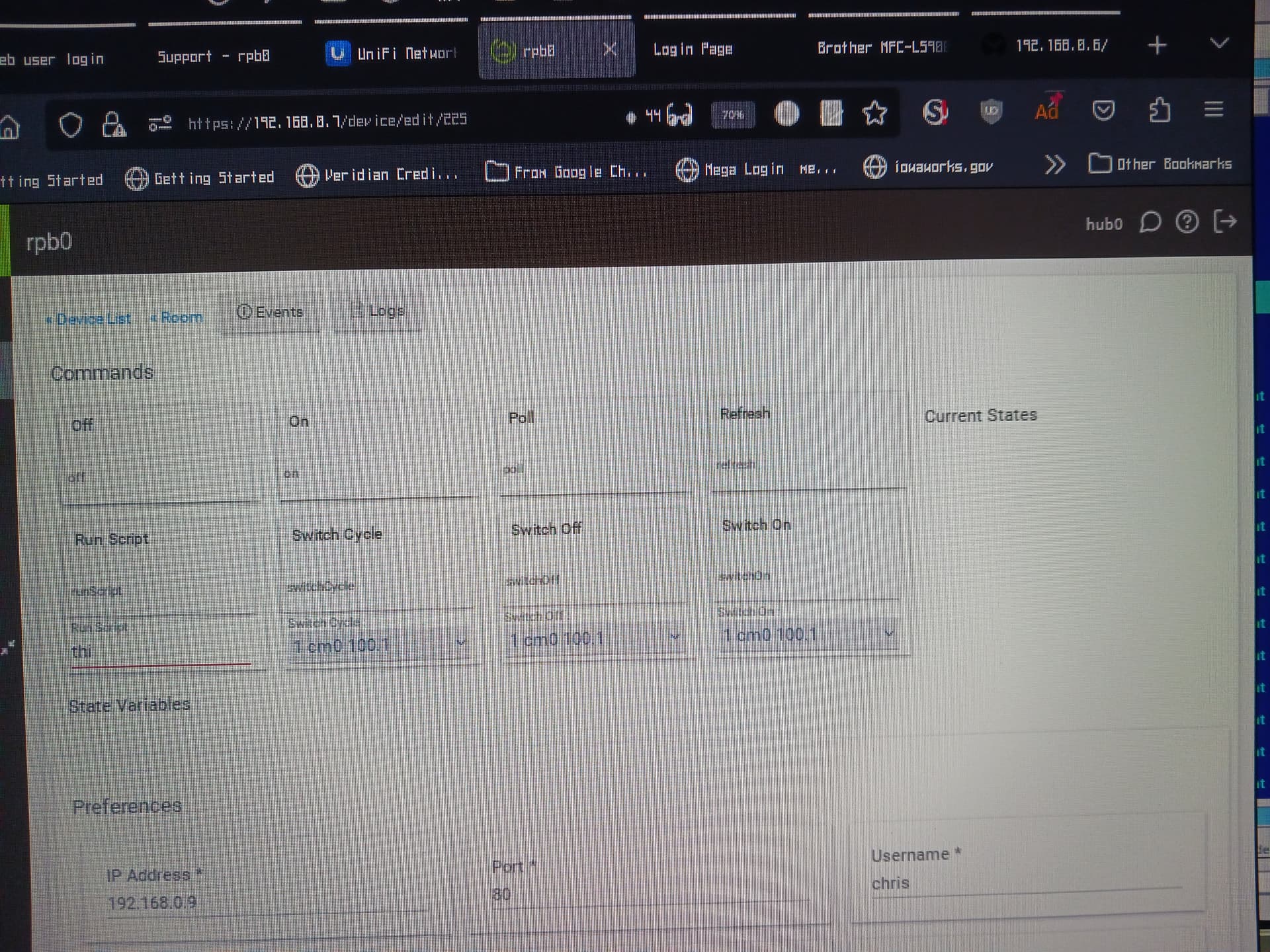

Hi guys, just popping in to mention that I have a DLI LPC9 (Web Power Switch Pro) running this. Was working great, but as of Firmware 1.14.6.0, it no longer reports status, in the "Current States" area, in the Device page, as well as not being able to run scripts. Is there anything that can be done, to help fix this?
I have an older web power switch, no wifi, and all has been well. My firmware is much older. Are you getting errors in the log from the driver?
just to clarify, the driver still works in a limited way.
im able to switch on, switch off, and cycle. i cant run scripts any more. and, it seems the page shows nothing in "Current States", as depicted in the screenshot of my browser window.
Additionally, there appear to be no errors in the logs.
However, the reason I upgraded the RPB's firmware, is because it resolves problems with generation of certificates, for HTTPS access. A good reason to upgrade, but problematic for my automation ambitions! I'd sure appreciate this being investigated.
hub is a c7 on fware. 2.3.6.144
rpb fware. 1.14.6.0 AVR 1.14.6.0
