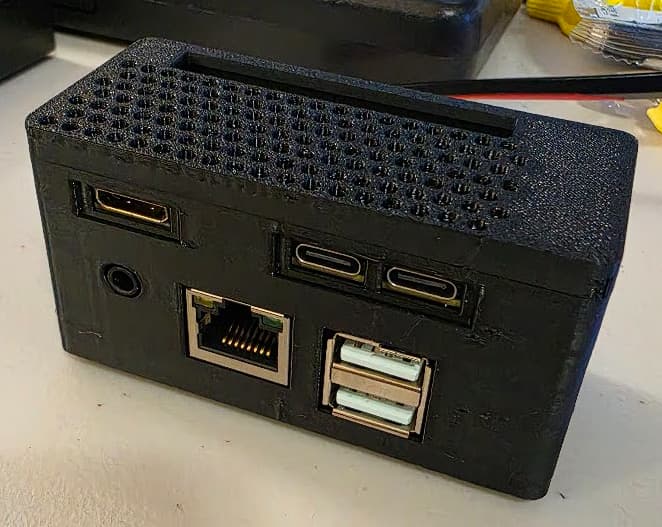

I did whip together an Orange Pi Zero3 + Expansion board 6 months ago or so... So cute! 4GB, storage and expansion board was like $65 at the time. Not sure you can even get the 4GB ram models any more... (you can: Amazon.com: Orange Pi Zero 3 4G Allwinner H618 LPDDR4 Quad Core 64 Bit Single Board Computer, 1.5GHz Support 4K Display WiFi Bluetooth (Zero 3 4G+Extended Board+Supply) : Electronics )
EDIT: Looking at my order history I guess I did an Orange Pi 2w too... Same allwinner CPU. Orange Pi - Orangepi
If only allwinner was a bit easier to do initial setup/bootloader and kernel updates on.... I think both have armbian builds, though, so that makes it a bit easier.
Yup. There are community builds for both.

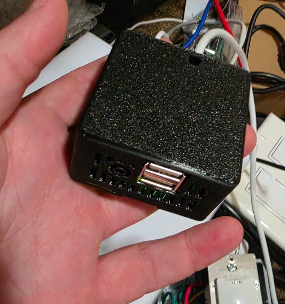

Ah cool, I actually found them.... Booted them both up and updated them. Both are running armbian.
They're so tiny and cute for a little SBCs. :heart: Zero3 has 4GB ram, 2W has 1GB.
The hole on top on the Zero3 case is for the wifi antenna, but I didn't bother attaching it since I use Ethernet.
