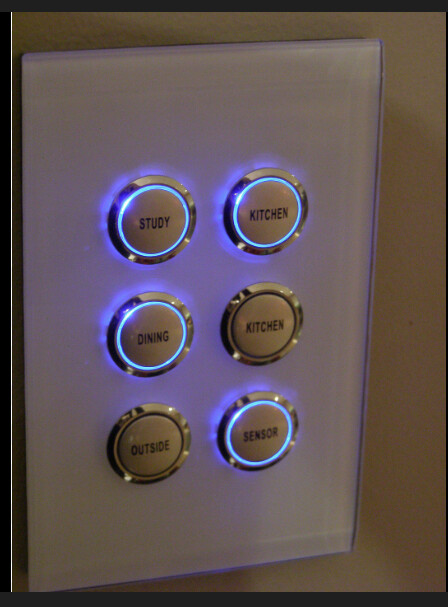

What I’ve done is use Clipsal Iconic wall plates, with momentary switches, and Aeotec single or dual nano zwave modules (multiple in some cases) behind them.
This option does give you more flexibility as you can mix and match dimmer and relay modules as required.
Eg
The modules are quite small, so you can stuff multiple into a wall cavity.

I don’t, I use Aeotec and Shelly zwave modules behind Clipsal Iconic wall plates and using momentary switch mechs. Eg
wouldn't that end up very expensive? aeotec dongle per switch plus clipsal panel plus momentary toggles.
Yeah it wasn’t a cheap solution, but there weren’t any good options for all in one solutions at the time, that also passed the WAF test.
