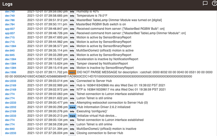

upgrading one hub now...
Utter failure.. everything worked perfectly
You can see the time gap at 07:39:00.134, where the reboot occurred.
At 7:39:48 is where I walked into the bedroom and told Alexa to turn on the lights. She did. They turned on.
I'm removing the reboot function

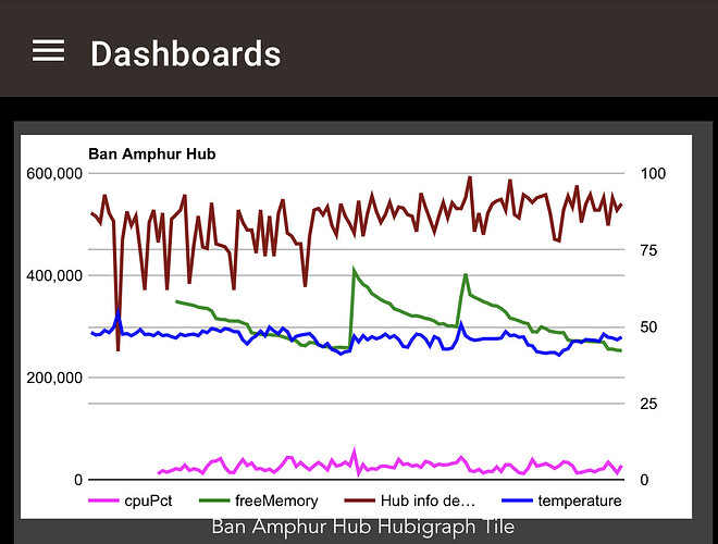

I think that’s wise. It’s advice that was given to me when I was having awful problems a couple of years back, and rebooting every night. The thought was that the reboot may have been screwing something in the database if it activated while something was underway on the hub. I did quickly find that the reboots at that time were not actually helping. I now use the hub info monitor app and reboot only based on free memory going below 220,000, which seems to be the point where I get rules relying on MakerAPI slowing down. You can see the reboot at 220k, another at around 250k when I upgraded a hub version, and it looks like another reboot is due soon… ![]()
