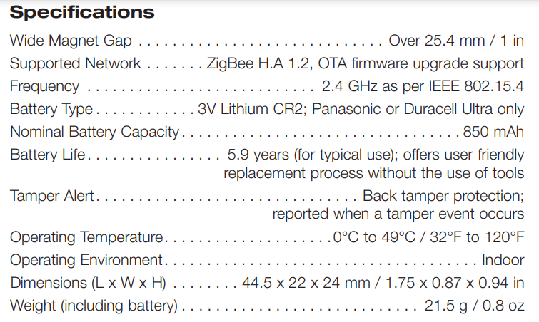

I've got one of these on the gate at the back of my yard. Measured the distance a while back but don't remember exactly, probably between 80' and 100' from the hub, through two walls (interior/exterior standard wood/wallboard construction). Works w/out issue. Like that it is very small and sleek (which isn't obvious from its product pic), and it's been trouble-free. Using excellent Zooz drivers from @jtp10181 with it.
Why have you been hiding these? :wink: Oddly I wasn't aware of a "Zigbee LR" category of devices. (I know, need to spend less time reading comics in class.) :slight_smile: Size/shape is a little odd, but would work well for stuff where WAF isn't a key factor. EDIT: Actually, I'm having difficulty figuring out exactly how big the sensor is from the pics...ah, found the specs. A little tall at almost an inch, but overall much smaller than I intially thought:
