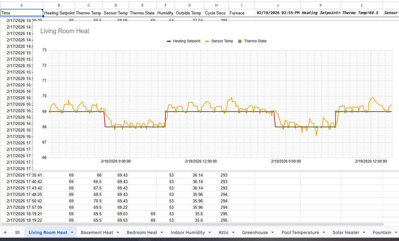

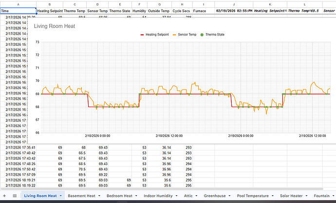

That's why I like sending logs to Google Sheets. Once the data is there, I can query it, sort it, or graph it however I want to.
People don't like my method since it uses a public sheet to avoid having to deal with Google login, but I've never had any issues with it for years. I really should just get AI to write a Google login to the driver I am using at this point, but I've just been letting it roll.
I don't have any data on there that would be of interest to anyone, I only log data that doesn't give away anything about my house being occupied or not, mostly tracking heating/cooling, temps, humidity, irrigation, and things like that.

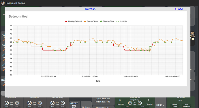

Edit: The other nice thing about no login, is getting the charts back out the sheet. With a public sheet, I can publish my charts and then use the URL provided to put them on a dashboard as an image, or use the interactive link, and put that in a link tile on a dashboard to open the graph in a full window, where I can click on datapoints to see actual values and times.
nice. I didn't think about this. We'll give it a shot, but still wanted something that just runs.
Mine just run. The charts I create use a range to the last row, so as new data comes in, it automatically goes on the chart, and appears on the dashboards.
I also have a cleanup script that maintains X number of days current data for each tab, or things get out of control quickly. I have one public workbook sheet with different sheet tabs for different logs, the Sheets script I am using to send the data sends the data to the proper sheet tab.
I have about 20 tabs on that sheet now, each logging different things, with their own charts to display the data.
On a Dashboard:
This came up in a previous post, where I posted the Apps Scripts I am using in Google for receiving and removing data, as well as the Hubitat driver I use to send the data. It should come up in a search in this forum if you are interested. I could hunt it down if you can't find it.
