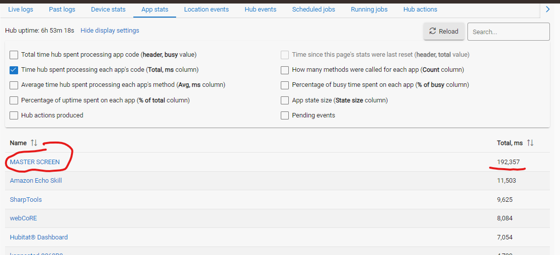

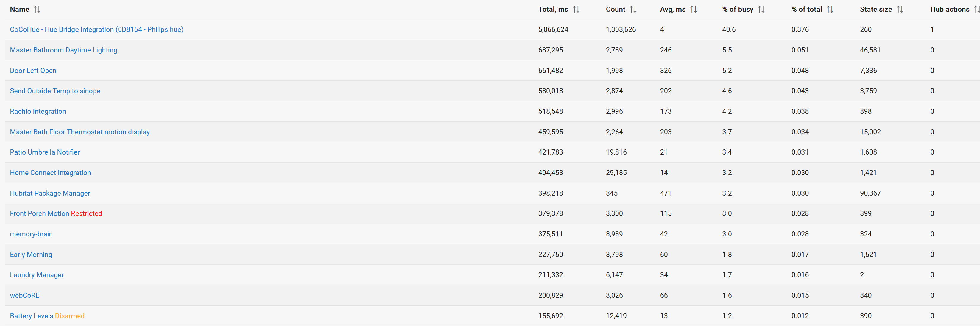

I am also suspicious about this log information. I have one dashboard called MASTER that I was allowing to run 24/7 in Chrome on a second monitor. I wonder if this could be overloading something ??? Note the ms compared to the next highest.
None of the preferences you show generate traffic one way or the other. They just affect what you might see on the hub.
