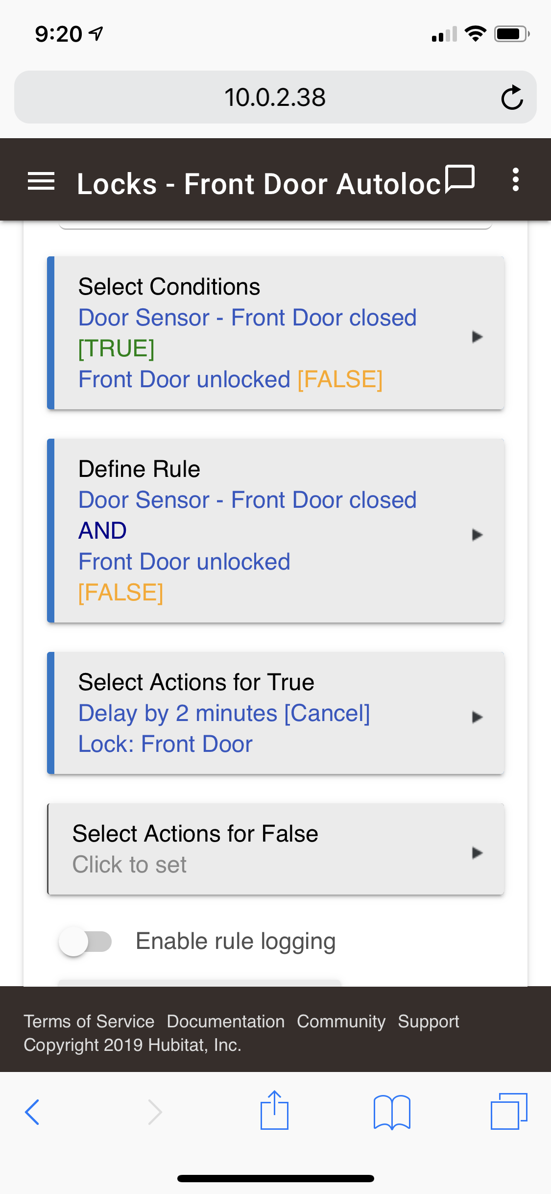

Here is what I use 24/7.
You want to set your rule like this it sounds like, you just have to pick a stop time you don't want the rule to apply as where I put "6:00 AM"
So, one question. That rule doesn't specify "door lock is unlocked". Any reason?
You could also add that in the "conditions" setting as well, and would probably be better. As that I believe would answer your previous question as to insure that it's not ALWAYS firing, just firing only when those conditions are true.
