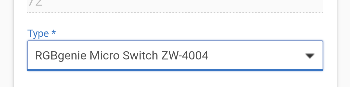

I picked up some Kwikset Connect 620s. They were paired to a random RGBW driver. Not sure if the fingerprint could be mapped to the generic Z-wave lock driver instead.
Here's the driver it was mapped to:
Here's the fingerprint:
fingerprint mfr:"0090", prod:"0811", deviceId:"23A8", inClusters:"0x5E,0x55,0x98,0x9F,0x6C
Tagging @bcopeland.
Thanks… Will get this fingerprint added
