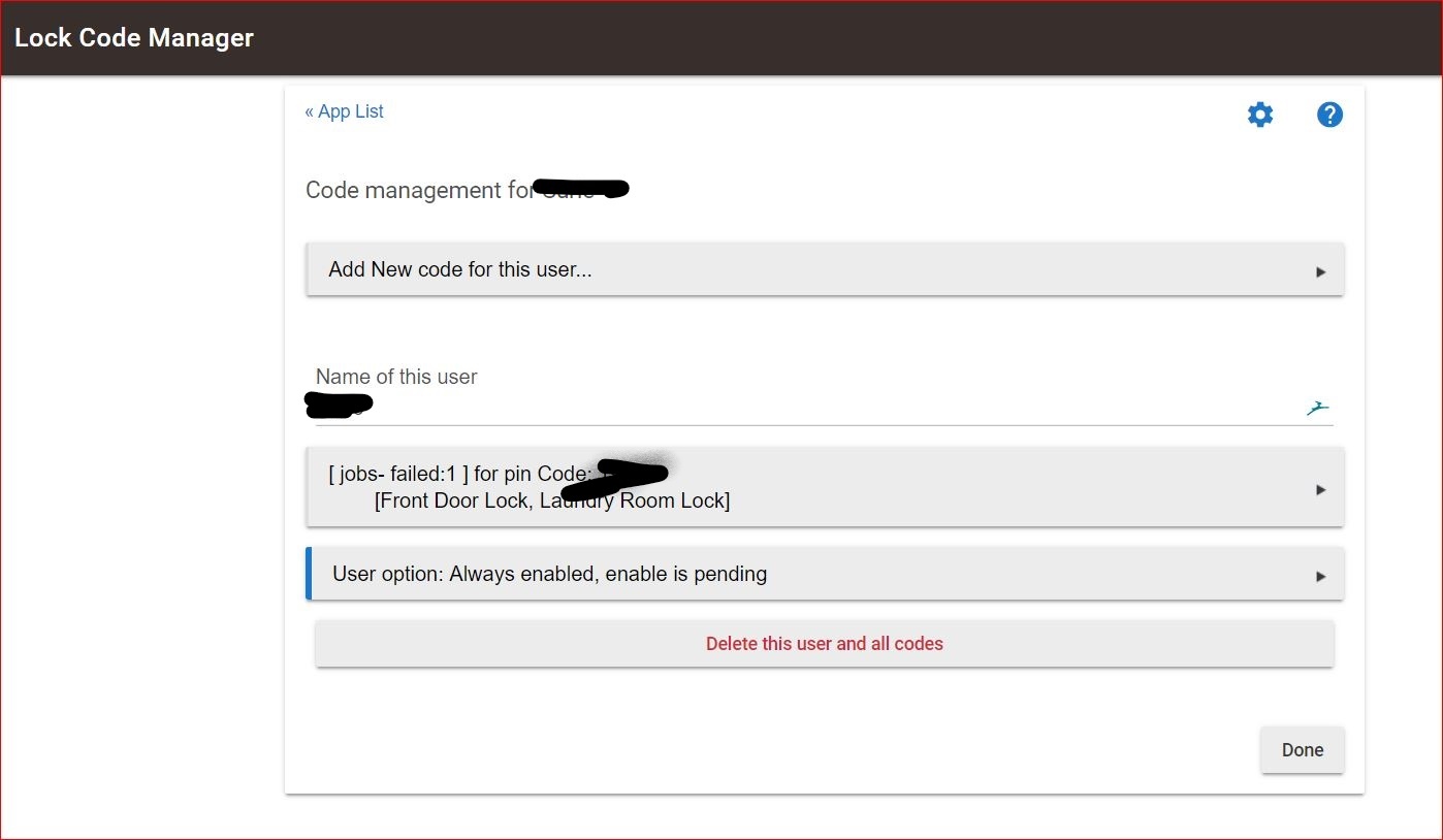

Step 1: Initial screen:
Then I tried to delete this user and associated codes, and pressing the Done button.

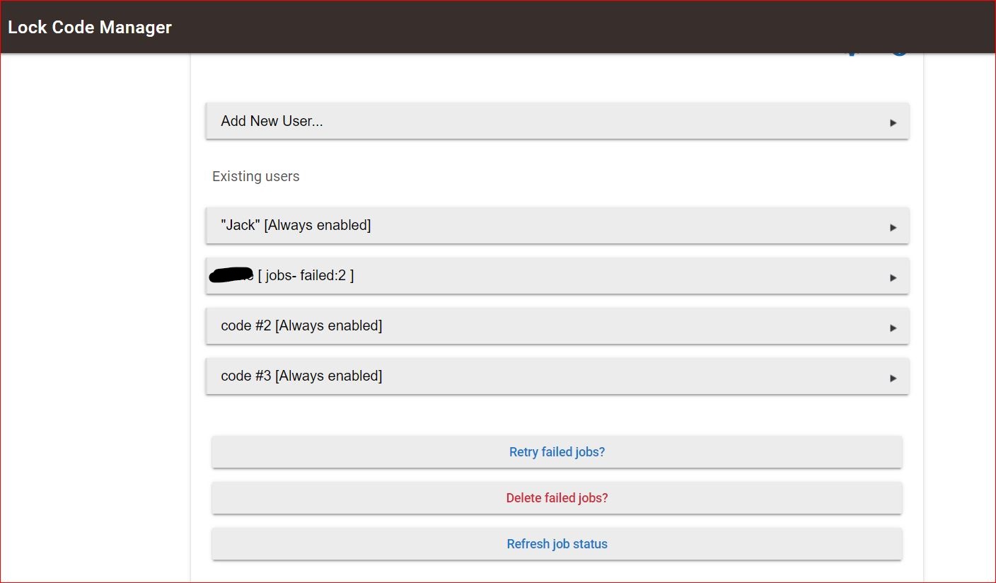

The following is the result:
Even though it says all deleted, the following is the status page:
and Retry failed jobs doesn't clear the queue. (I'm not sure why the jobs failed, but didn't report an error).
a failed job indicates an issue with the hub having difficulty in communicating with the actual lock.
It's best to make sure that the lock is working correctly (try adding and deleting codes, locking and unlocking) from the driver details when this happens, if that's working correctly LCM shouldn't have any problems managing codes for that specific lock.
