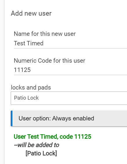

Mike:
I just tried this out, and had the same results as @ehfortin - at the appointed time for the code to become active (5pm in my test) the timed user was deleted.
I created the new timed user:
2023-07-19 16_24_40-Hubs, Network, & Tech
Now when I look at users/codes after 5pm, the timed user has been deleted. I don't want to post pics w/my family listed so I'll PM a few more screen shots to you, as well as logs from 5pm on (debug logging on).
But headline is same result - new timed user gets removed when it hits the time when it is supposed to be enabled.
