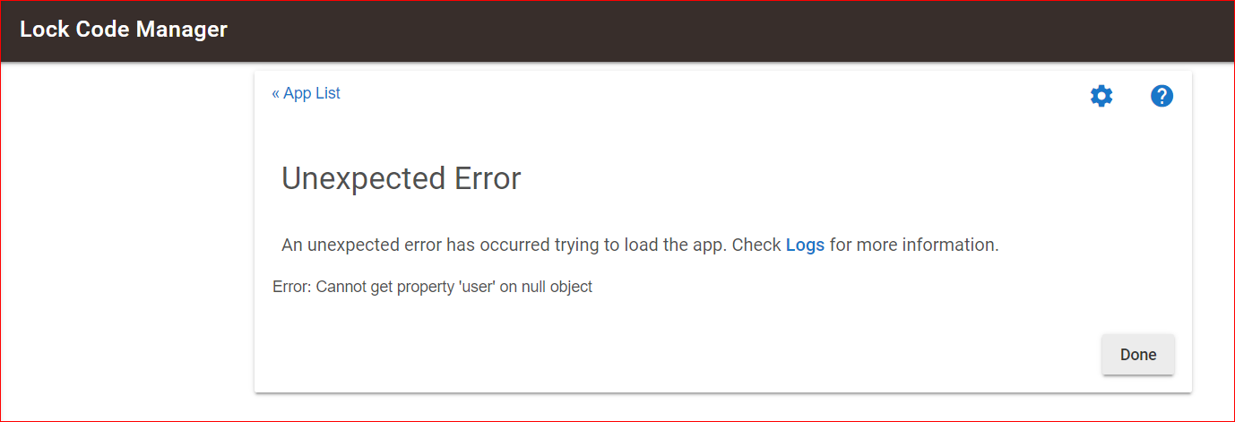

  2. When trying to add a new lock code, the following error message shows:

LCM is expecting the lock driver to already have any codes downloaded from the lock, given the error that the driver reported it would seem that the driver didn't get the codes from the lock when it installed.
need more info:
which lock is this?, and after installing it what if anything was contained in current states lockCodes?
Don't post the lockCode info if there were any actual codes shown...

Surely the LCM should work with the lock to determine what codes are already present on the lock before bombing out with an "unexpected error"! That's not very user friendly.

I will try and go back to the drawing board, and document exactly what's causing the error, and try and show how to reproduce the error. That way the team will have all the info that's required to squash these bugs.
yeah, that's my point, and so far you're unable to remember if it was able to fetch any codes from the lock or not when it first was setup...
It's obvious that it didn't, since the lock refused the code you sent to it via the driver, the only way this can happen is if the codes didn't download from the lock in the first place, and that's a whole other issue and can vary from manufacturer to manufacturer and mesh to mesh.
If the driver didn't get the codes from the lock, LCM sure isn't going to get it.
LCM gets the codes from the driver, the driver is responsible in getting them from the lock...
