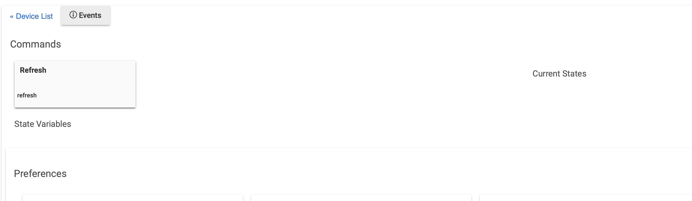

Can you confirm that OpenWeather data is being displayed under CURRENT STATES on the OpenWeather device, like;
Mine is blank.

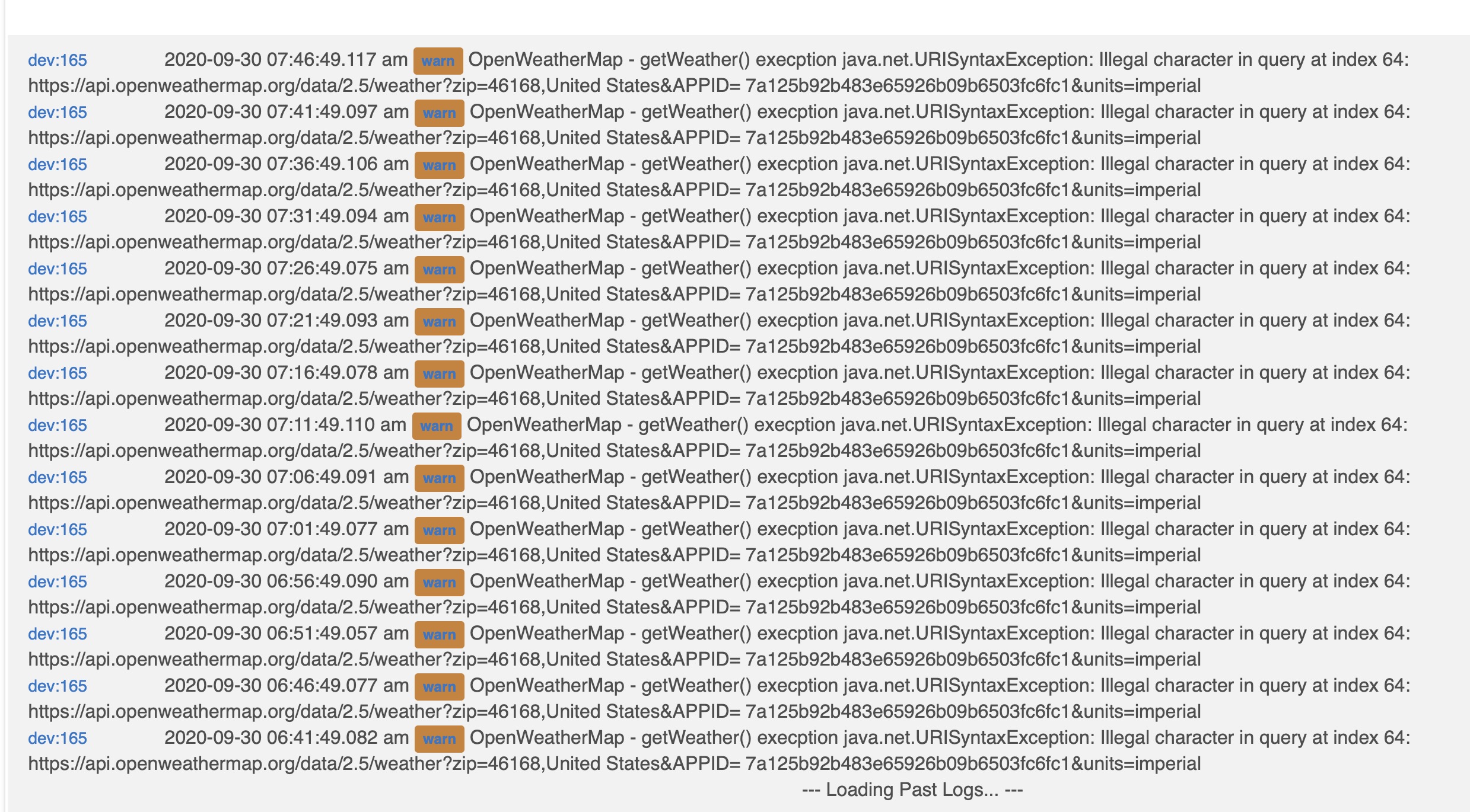

Check your logs and maybe post any errors found for this app.
Api is in there. Lots of errors in log.
Did you add the United States part in the ZIP? Not sure if that sould be there or not. Tagging @Matthew, he might be able to help with this error.
BTW, I would blank out part of the API key so no one uses yours or change it later if possible.
I reached out to OpenWeatherMap. They suggested changing Country Code from United States to US. That worked. Thanks for pointing me in the right direction.
