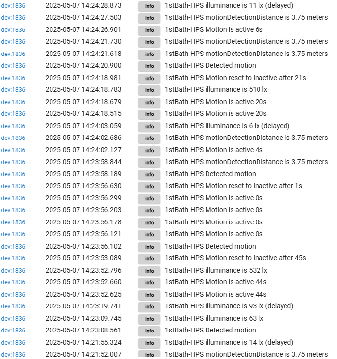

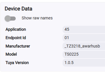

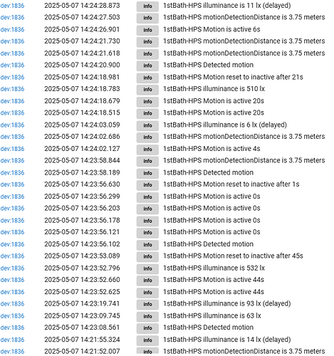

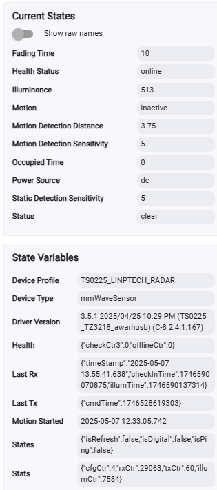

Below are screenshots of device data & current states, and logs from the sensor while I walked in and stood 2-3 feet in front of the sensor for a few minutes. I've read numerous posts where various folks claim they work well (but still need to rely on a PIR), but I'm at a loss...is there something I'm doing wrong here?

The logs that you submitted show very erratic behaviour of your mmWave sensor...
There should not be 'Motion is active 0s' logs sent four time in one second.
There should not be 'motionDetectionDisatance is 3.75 meters' logs sent so frequently!

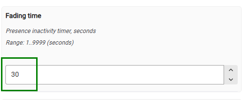

I would also increase the fadingTime parameter - 10 seconds is too low / too optimistic for a reliable detection of 'no presence' state in a problematic environment :
Try to make the mmWave sensor work OK in a near-ideal environment first - you will have a good starting point for adjusting the sensitivity settings when you move the sensor to its final destination.
First, check or change the power supply - these 'motionDetectionDisatance is 3.75 meters' logs should be seen only when you refresh the device (I suppose you are not refreshing it from a RM5 rule), or when the device is rebooted.

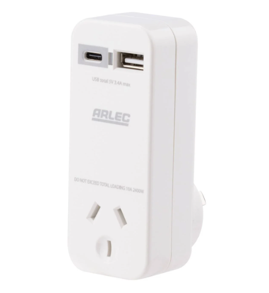

however: your suggestion of the power supply is intriguing. its a garden-variety 240VAC-USB power supply similar to but not the same as this one:
its worked reliably and without issues powering an aeotec multisensor 6 for at least 2-3 years now. But just maybe the power input circuit of the aeotec has a larger capacitor than the linptech which could buffer any fluctuations from the PSU? don't know if thats grasping for straws but i'll try to find another USB source to see if it makes a difference.

not sure offhand..but its the one that was in the box with the linptech.

I'd update them to 1.0.6. While the difference is the led toggle it might correct any underlying issue.
love to, but don't have a Tuya hub, just a hubitat one.

Hi @kkossev right again! all it took was a simple change in USB cable route so it didn't cross over an LED light strip(!). This made a HUGE difference. Like night & day. Touch wood its now solid as a rock and it actually does what its supposed to, more detailed testing and tweaking aside.
key points for me:
  • the significance of the repeating motionDetectionDistance log entries which indicated the device is rebooting.
