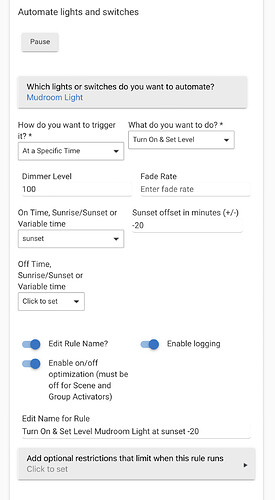

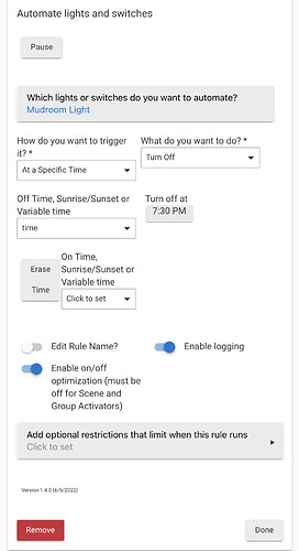

Attached are my latest settings. Please advise:
Ok the probem is your timing is overlapping... You have the light turning ON at sunset -20 but having it turn off at 7:30 pm. The sunset -20 in your time zone overlaps with 7:30 and that's taking president. So either set your on at 7 or whenever and your off at 7:30
