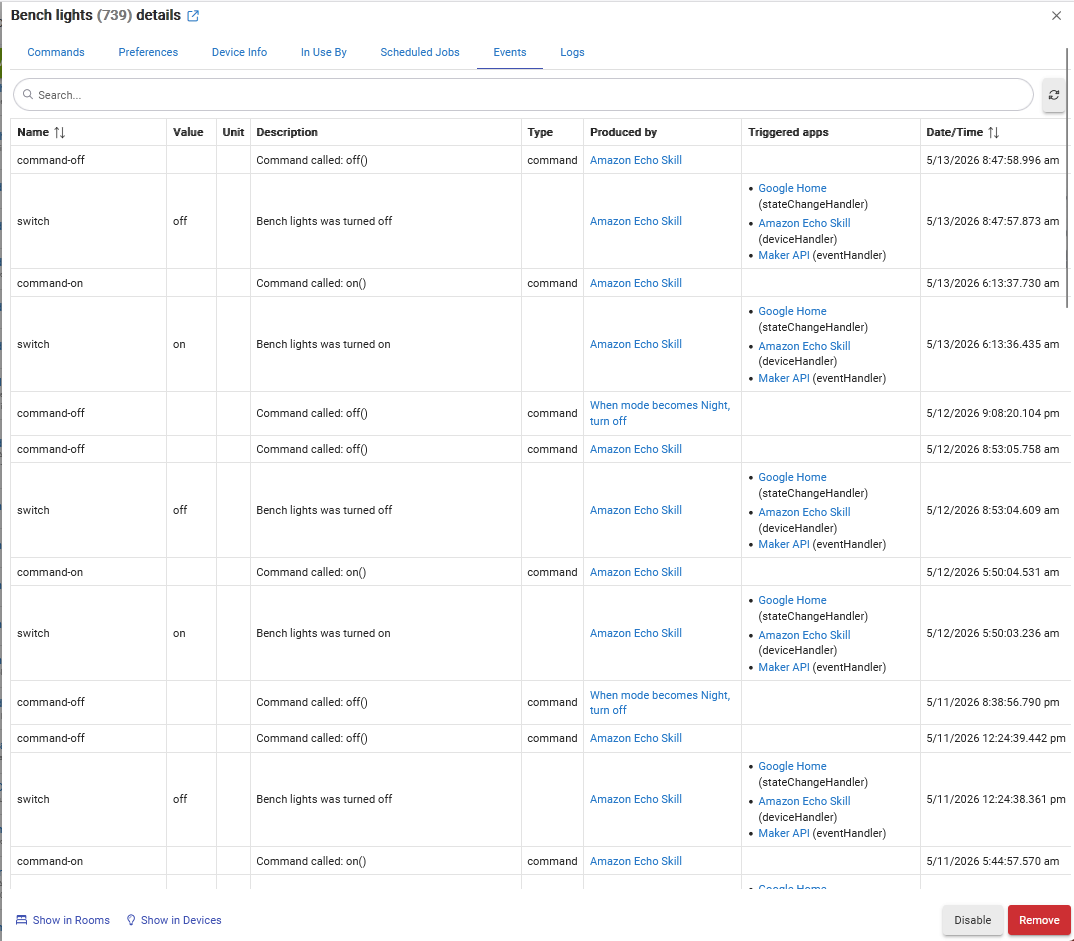

I have a group of lights (called Bench Lights) They keep turning on randomly. I have either disabled or removed all rules/apps that group but they still keep turning back on after approx 10 minutes.
I have a C8 running the latest software(beta 2.5.0.139).

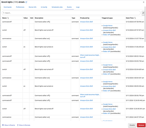

The attached log does not have all events of the lights turning on.
Any ideas how to track down what is triggering the lights to turn on is most appreciated.

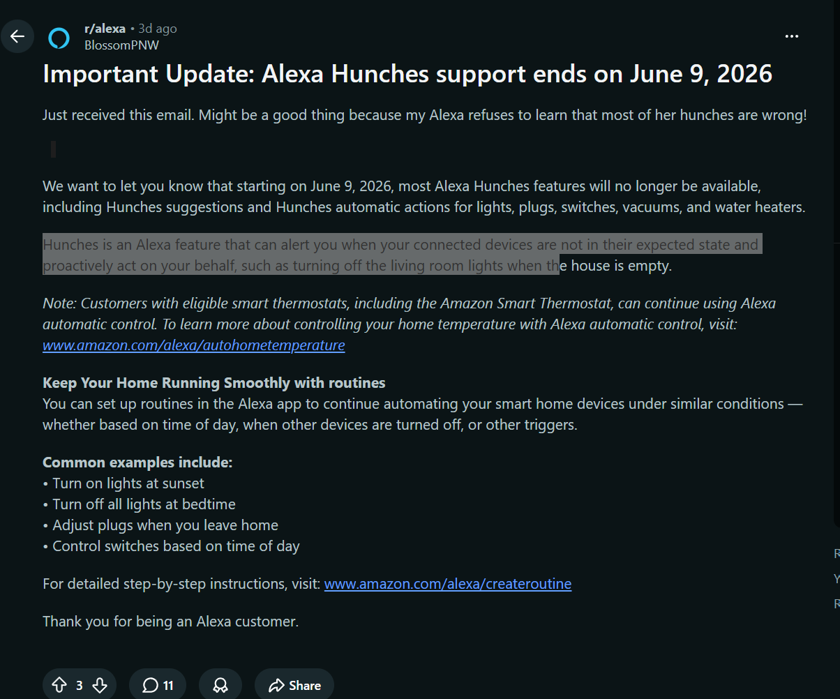

Look to the produced by column in your screenshot. Amazon Alexa is the culprit which is likely their Hunches feature that was turned on. Disable hunches in the Alexa app and problem solved.

The log does show when I asked Alexa to turn the lights on at 6:13am and off at 8:47am but does not show the approx 15 times after that they turned on by themselves. :frowning: I feel like the house is haunted
Well, this is some welcome news!

Praise and praise again... Thank goodness it's going away.

Are you looking at the Events tab for the device itself that is getting turned on? It should tell you what performed that action, even if it was not Alexa.
@ritchierich Thanks for this suggestion. I have disabled Alexa and all seems to be working as it should. Its very strange though as Alexa has not automations/routines at all so should never have trigger anything anytime.

Hopefully after June 9th as @ogiewon mentions above this all goes away.
