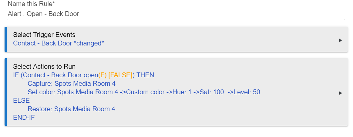

Ha. So the rule seems straight enough.
I first tried setting the color to Red by selecting Red off the drop down. The light changed to a pale green. Changed it to a custom color using 1/100/50 for my values. That got me a nice ruby red. When restored those Osrams don't let me down; Emerald Green!
I reset them to color temperature 2600. Open door; RED. Close door; GREEN.
Maybe it's not the bulb; be right back... So I manually changed the light to Yellow. Opened the Door; Red. Closed Door; Yellow. I think since the bulb type is Color RGB, the capture is capturing whatever color was last set instead of the Temperature setting that I want.

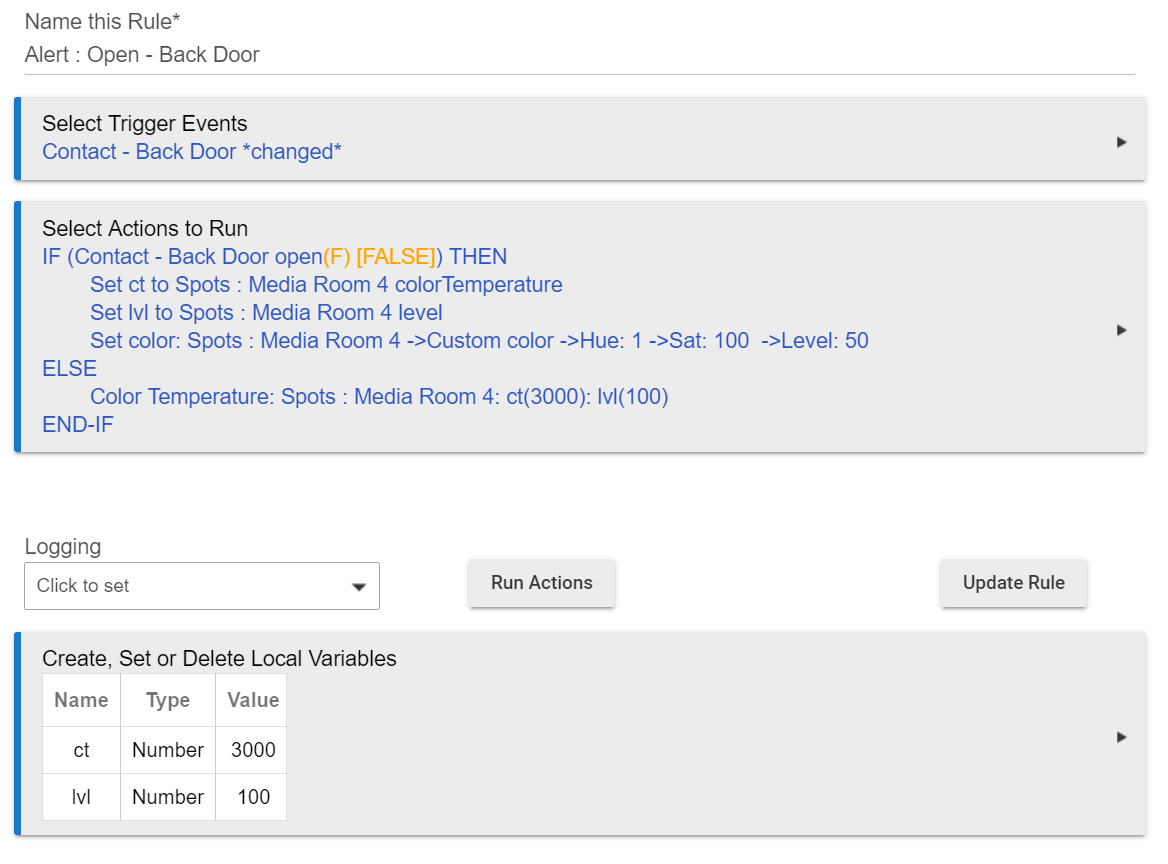

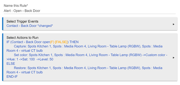

Well just for fun. I went back to my rule and added a few more bulbs. A Sengled RGBW and a Hue RGBW connected through a Hue Hub. The Sengled and Hue work correctly. The OSRAM does not. So it's RM and OSRAM that don't interact correctly. If your Hue bulb isn't working you should double check your rule. Are you closing out the IF .. Then .. Else with an END IF?
So the work around for crummy OSRAM bulbs is to use variables. I used local variables in this rule. Works as intended. Door Open; RED / Door Closed : [restored to correct CT and Level].
The Hue lights should be working with capture/restore. If they aren't you can always go the local variable route.
