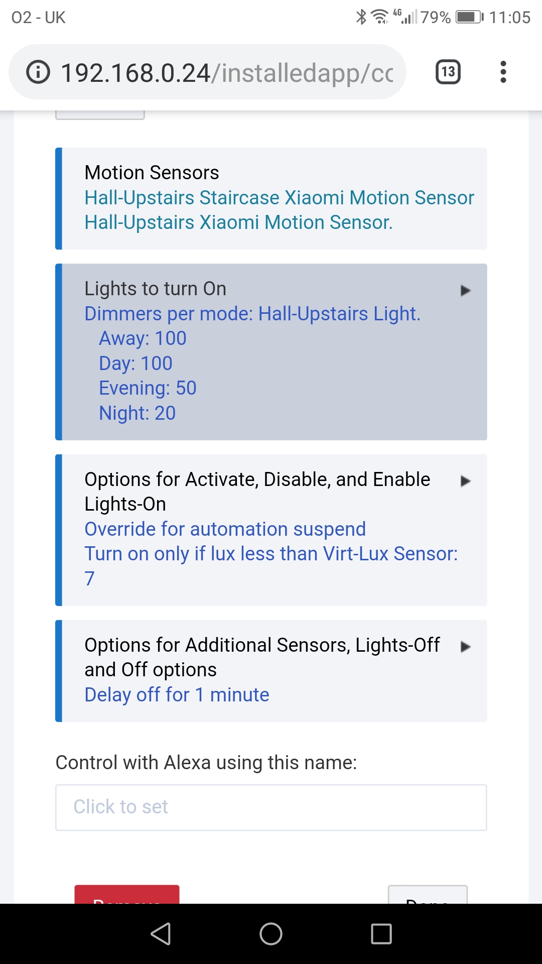

Here is the motion app rule.
EDIT. Just looked at the events log for each device and can see that the OFF command was sent to each device but they did not turn off for some reason.
So the rules did work as expected. Must have been one of those things.
