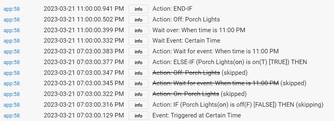

I do have logging enabled and this is what I am seeing in the logs:

For some reason... tonight the task worked as it should have and the lights turned off properly. Not sure what was different about tonight vs the past couple of nights, but I'll keep an eye on it for the next few days.
