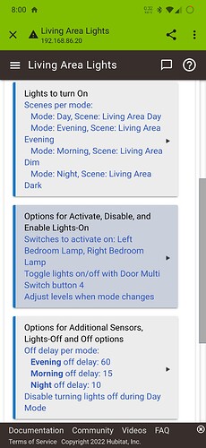

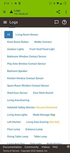

Please enable logging in Motion Lighting. Also, please show a screenshot of the Motion Lighting main setup page. I fixed it so you can post a picture here.
I took these yesterday. I'll grab fresh ones when I get home.

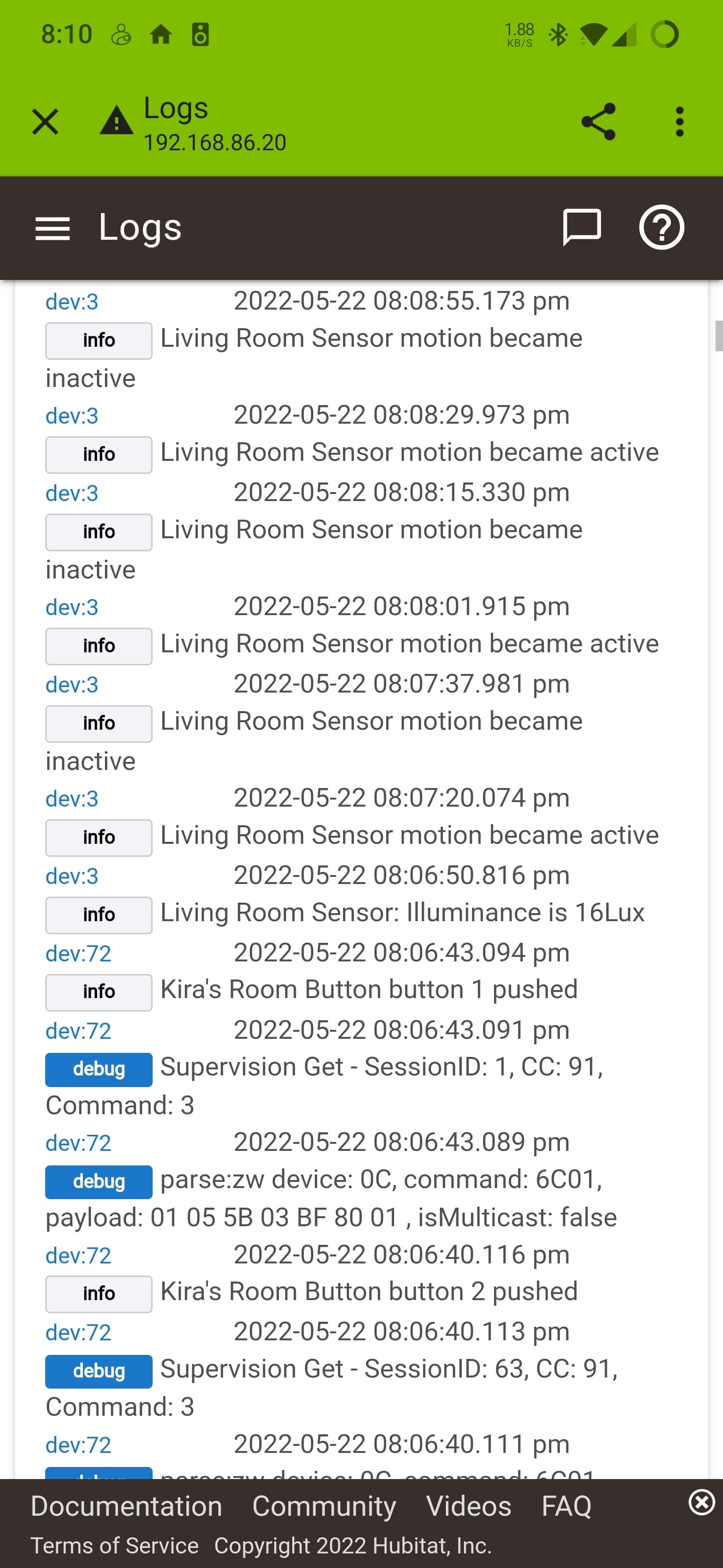

I took the screenshot after pressing the button. The lights did not actually turn off. Had to reboot after to get the lights to respond.

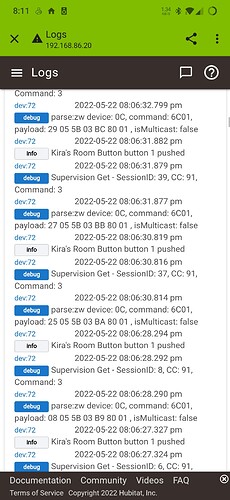

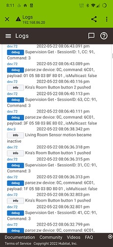

I have more logs. I arrived home to find the same problem again. This time it happened on its own. It seems to be when a scene is activated or turned off.

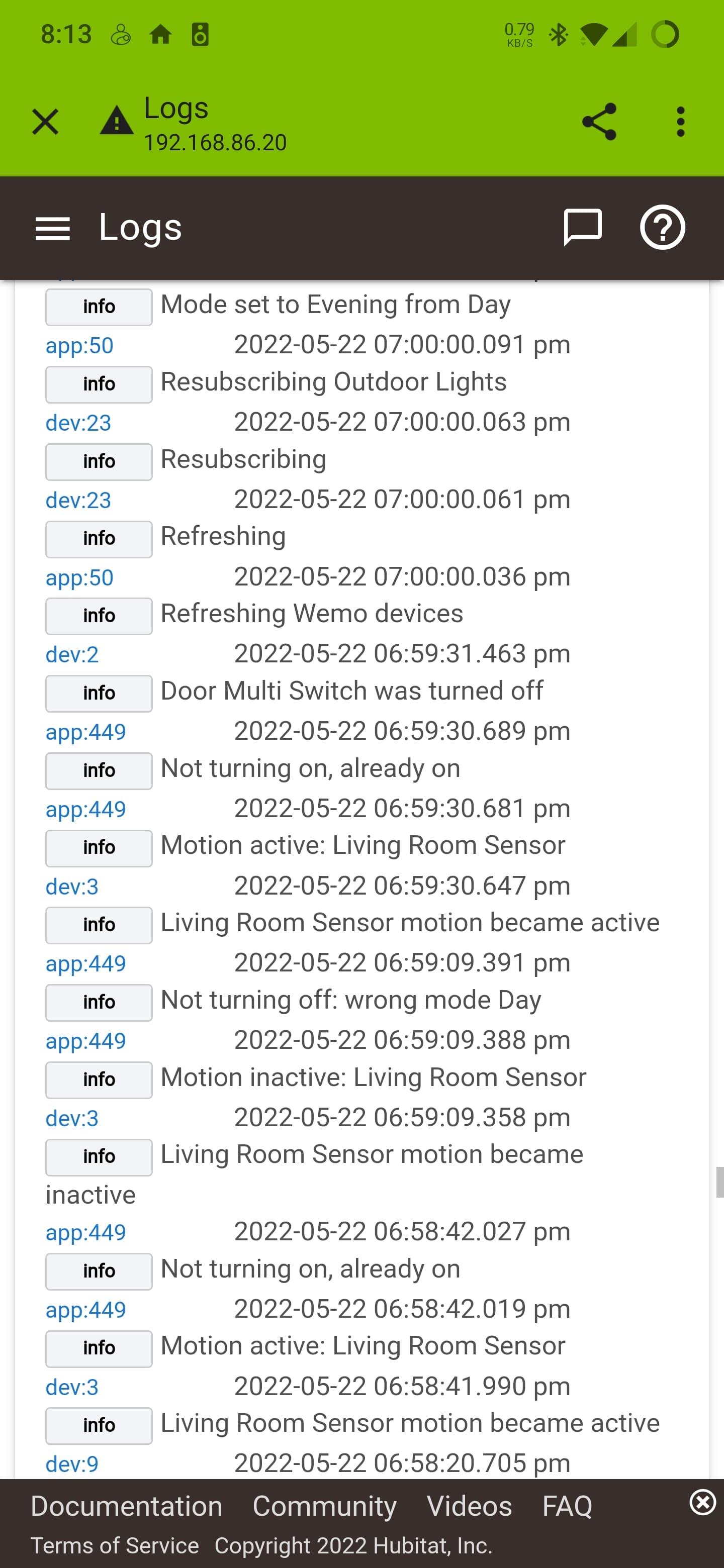

On the first log you can see hubitat reacting to motion and following the rile accordingly. It keeps working fine until a mode change triggers a new scene.
After the scene is triggered the app stops responding to motion events.
Later I get home and try to turn on my daughter's lights, this is on a completely different rule, button, and scene than what made it crash but it won't respond now either.

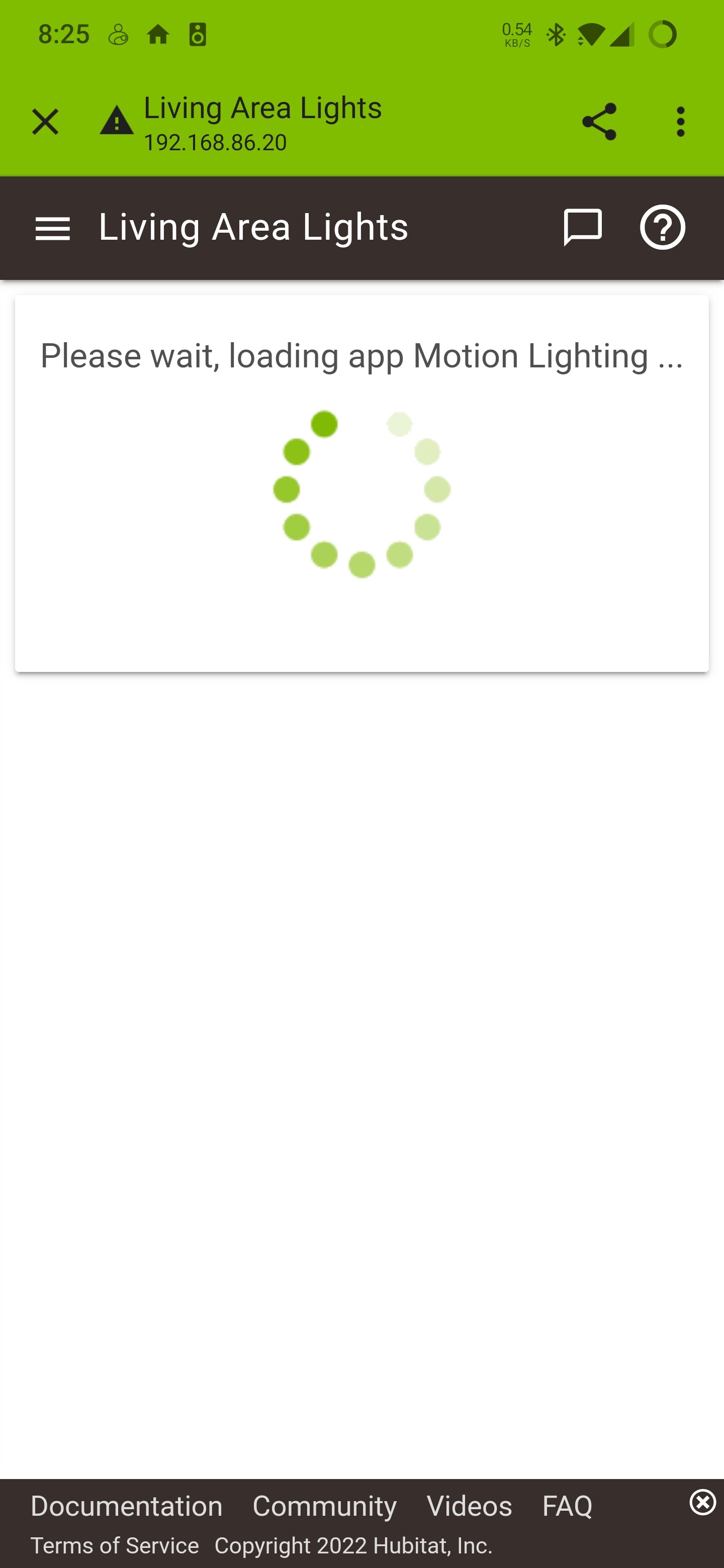

Hubitat will stay this way until I reboot. It also becomes impossible to access any, motion lighting, groups and scenes, and button controller rules until after a reboot. Trying to access any of those roles is met with this screen and never loves past it.
Whatever driver you are using for that device is going into an infinite loop, and this in turn is killing your hub.
What is the driver? This probably has nothing to do with Motion Lighting, beyond that perhaps it triggers this cascade of issues. You have to go back to that error you posted before, and figure out what causes it.

I have a very hard time dealing with phone screen shots. Do you have a laptop or desktop? I just can't help with the logs shown the way you are doing it. Do you know how to isolate the logs to only the relevant app?
I'll get you PC logs tomorrow. I left my laptop at work. Are you talking about the filters up top? Or turning off logging to other stuff altogether?
Btw. Thanks for the quick replies!
I appreciate the help. I just got my HE on April 1st.
Yes, these help, so you only show relevant information, making it possible to see what is going on.
