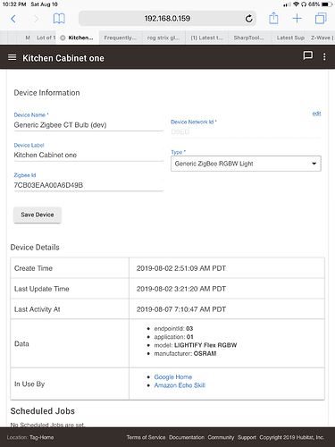

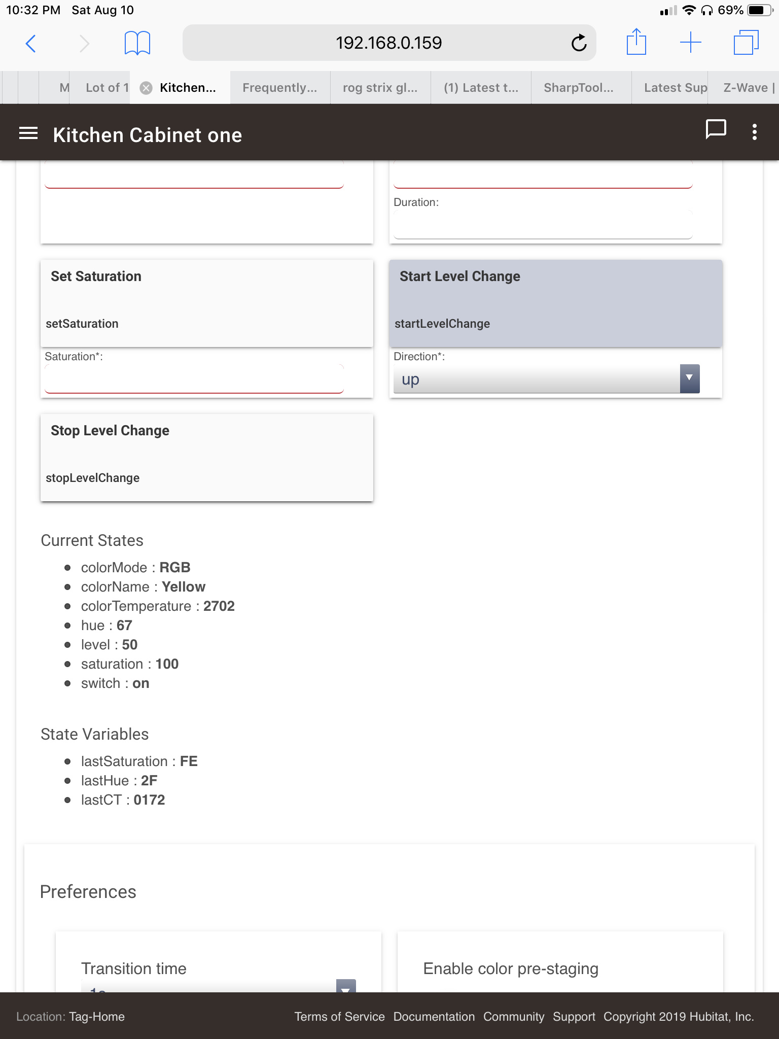

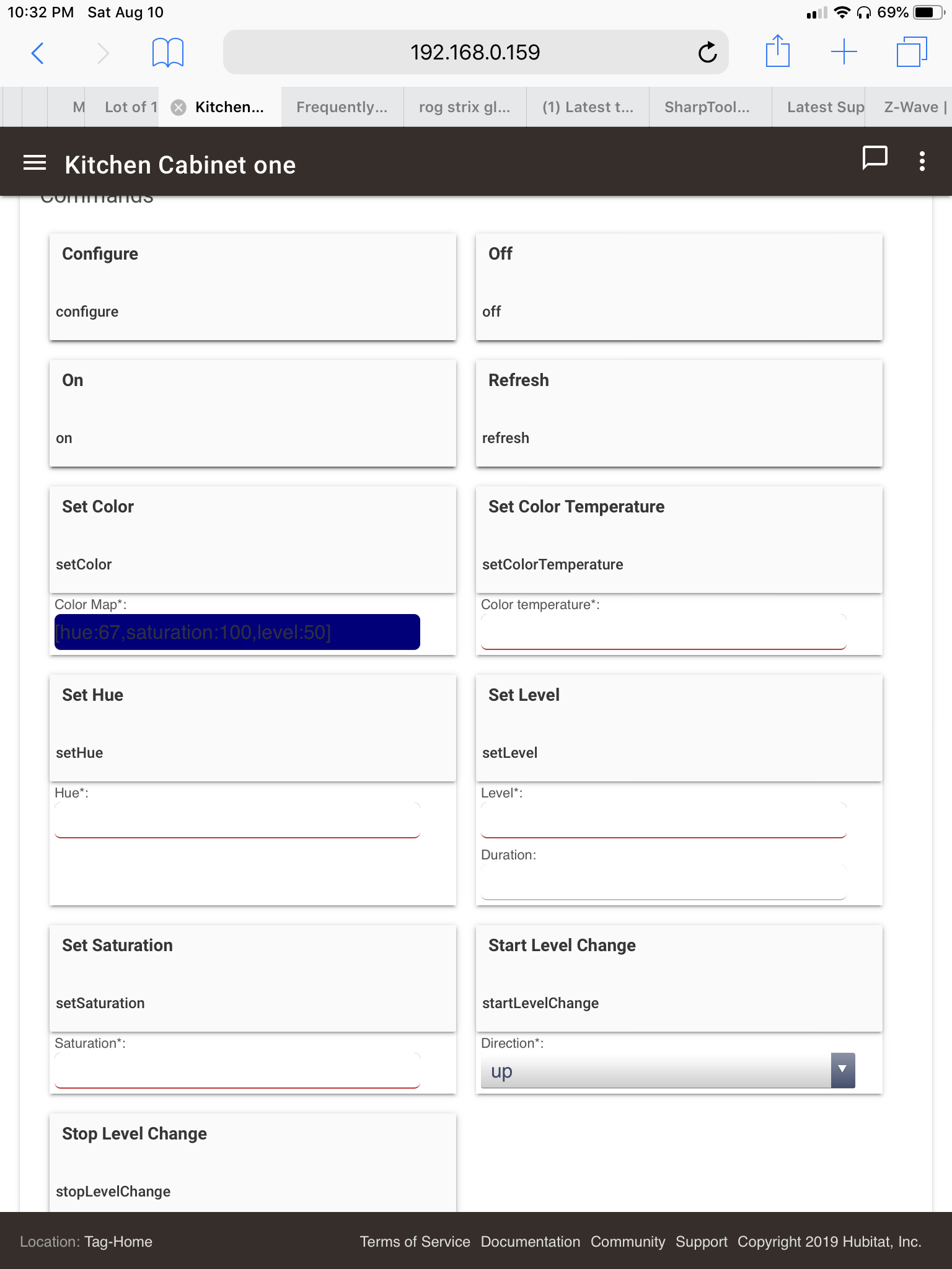

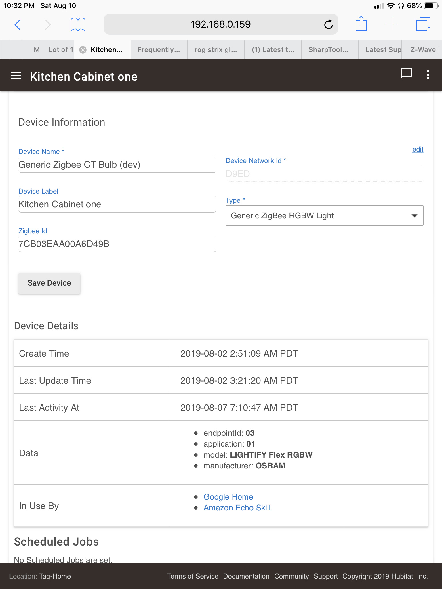

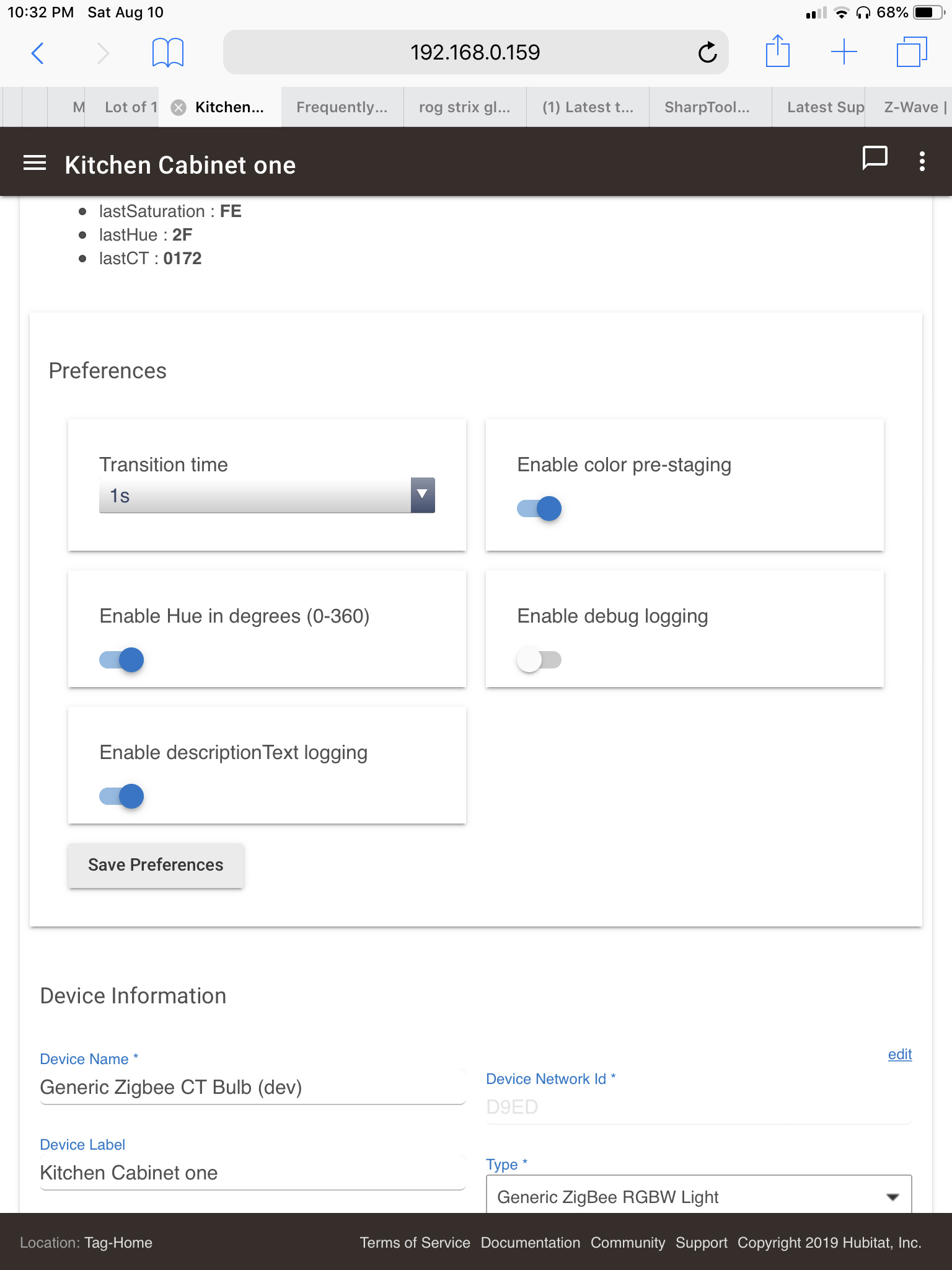

I have 3 sets of Lightify flex strips that’s I use as under cabinet lights. They were previously working great with Wink 2 and Alexa. Now that I’ve switched to Hubitat, if I choose a color either in Hubitat, Alexa or Google Assistant the colors will be wrong. For example I will choose blue and get green, or choose red and get yellow etc. I set tings up with the generic RGBW driver. Can anybody help me to troubleshoot what I am doing wrong?

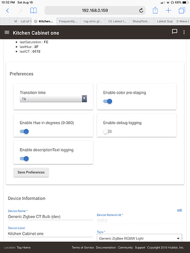

I think if you deselect 'Enable Hue in Degrees' and save preferences on the device page, you should be good.

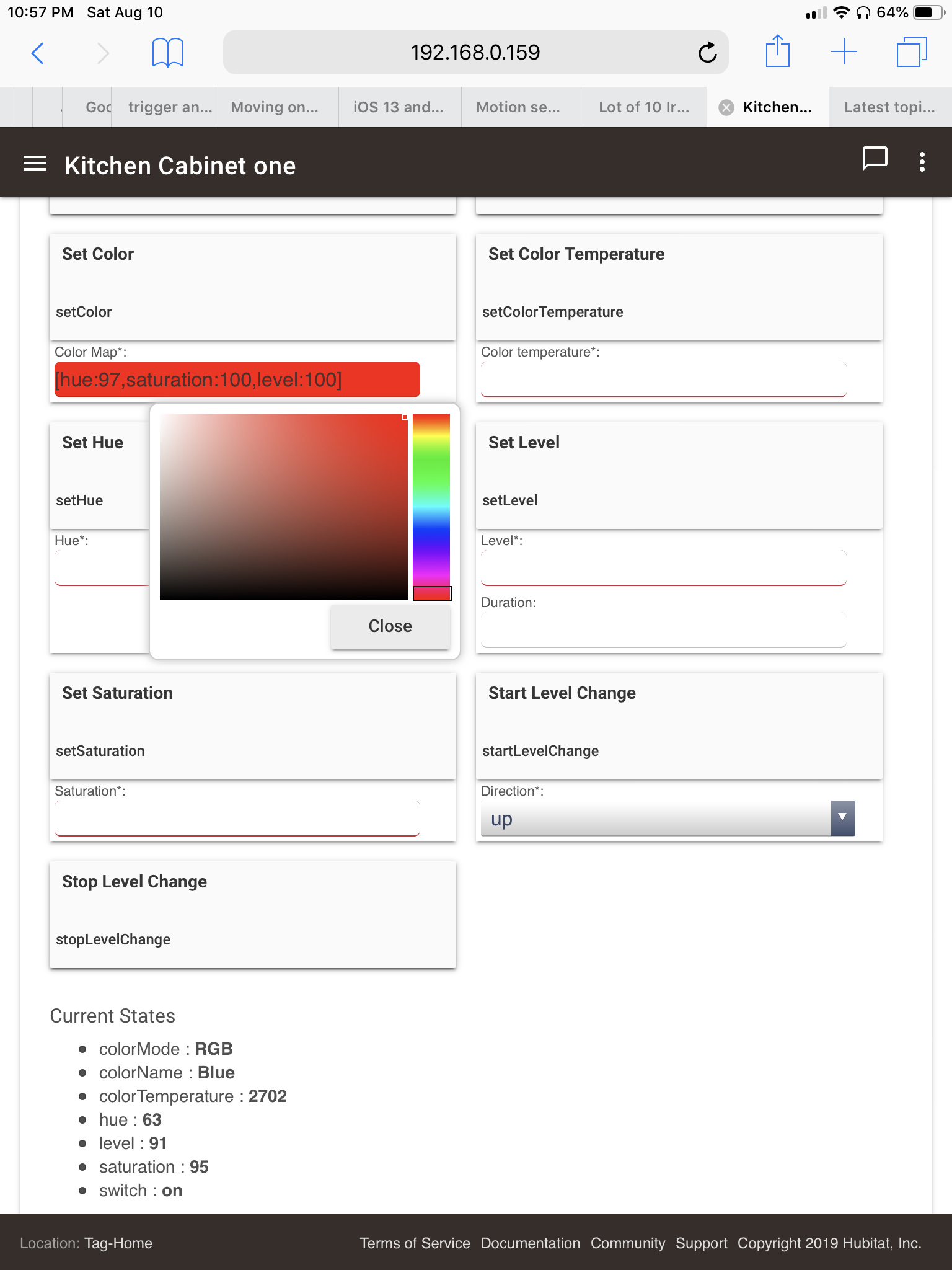

I just tried. I choose red but get blue....
Okay, after a few minutes it started working as it should. Thank you for your help!
