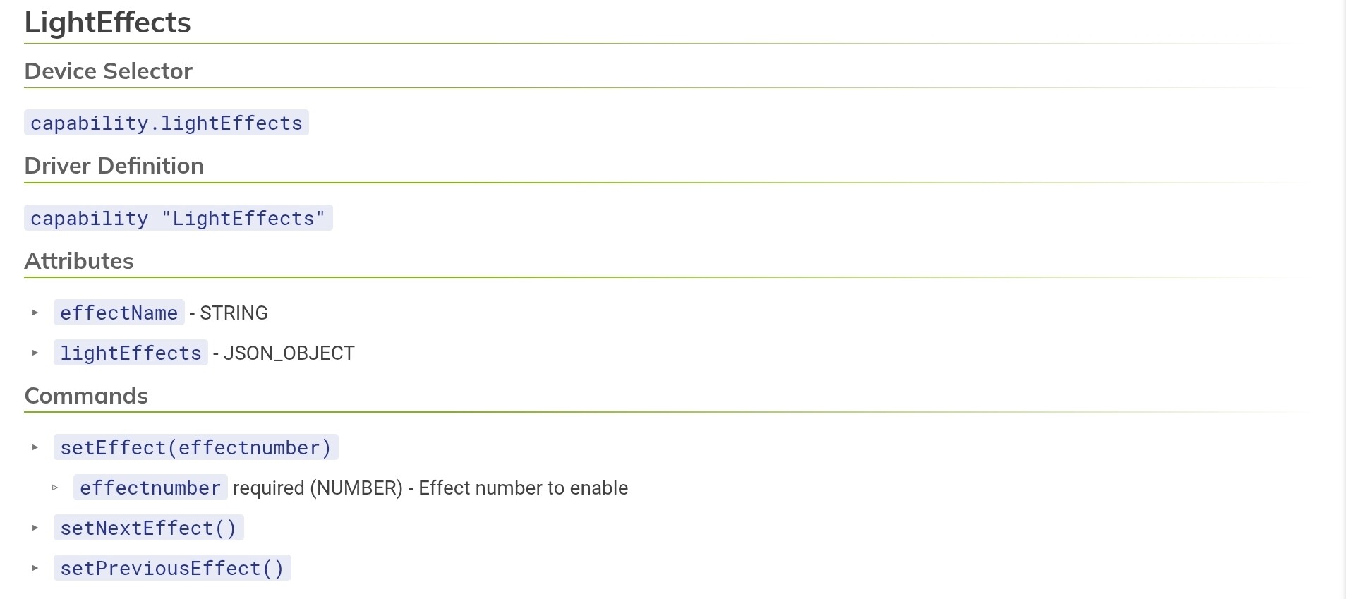

I hear you, and for the longest time I didn't use the LightEffects Attribute. On my devices drivers, the Scenes/LightEffects have always been stored in State values for this purpose. Recently I was asked to look into the LightEffects Attribute since it is part of the defined standard. The below image is from the Hubitat Documentation and show how the capability is defined.
My concern is maybe this capability needs to be re-evaluated with this issue. I can imagine as light effects continue to get more poular this limit may get hit more and more. It also isn't wihout some precedent for Attributes to be used to store values in JSON format as it is also seen with devices with Fan functionality.
