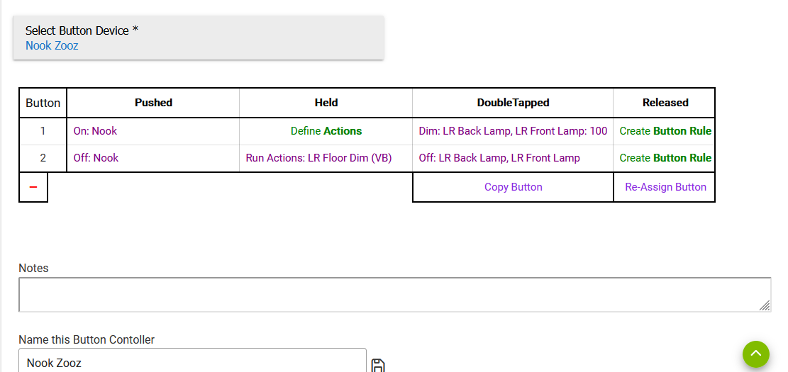

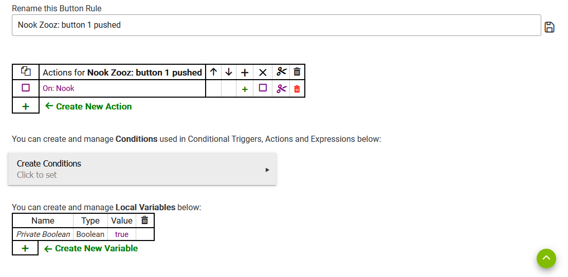

Here's the screen shots. I have some functions for the buttons being double pressed, etc, and those work fine as well. But I can't find anything set differently between button 1 and 2.
Screenshot 1
Screenshot 2
Screenshot 3
Here's the in use by list.
Hmmm... That does seems like it should work.
If you go into the Actions for button 1 being pressed (screenshot 2) and turn on logging, what do you see when you have the logs page open while you press button one? Turn on both Triggers and Actions logging.

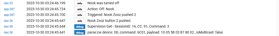

In the mean time, I tuned on the logging for both buttons 1 and 2, and after pressing them each, I get something different.
For Button 1
For Button 2

I think the logs you posted are more informative. It still looks like it is not triggering the Button Controller Rule for some reason.
