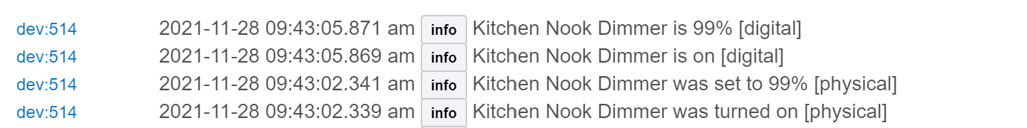

I just watched this happen. There is no automation connected to this light that makes it turn on (flash yes, but not just on)
Hub is on 2.3.0.113
It's a Zooz dimmer on the Generic Z-Wave Driver

All 3 rules listed in "in use by" make the light flash, not just turn on, It's basically the "alert" light in the house.
