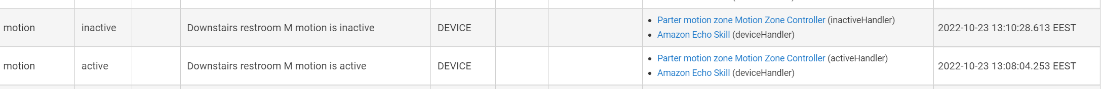

Screenshot from motion events, sensor reported correctly inactive.
And as you can see the light has not turned off ( last event is me turning it off hours later when i got home)
