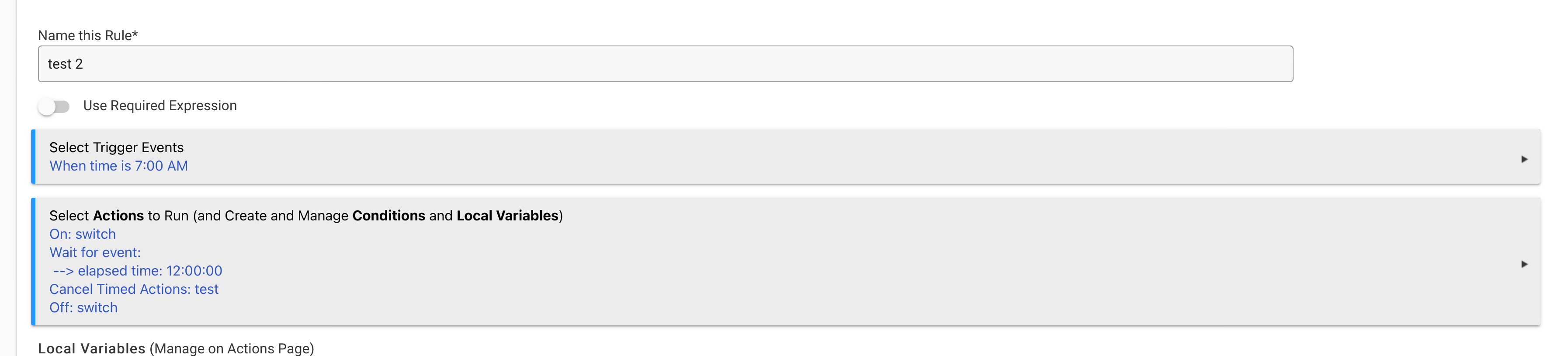

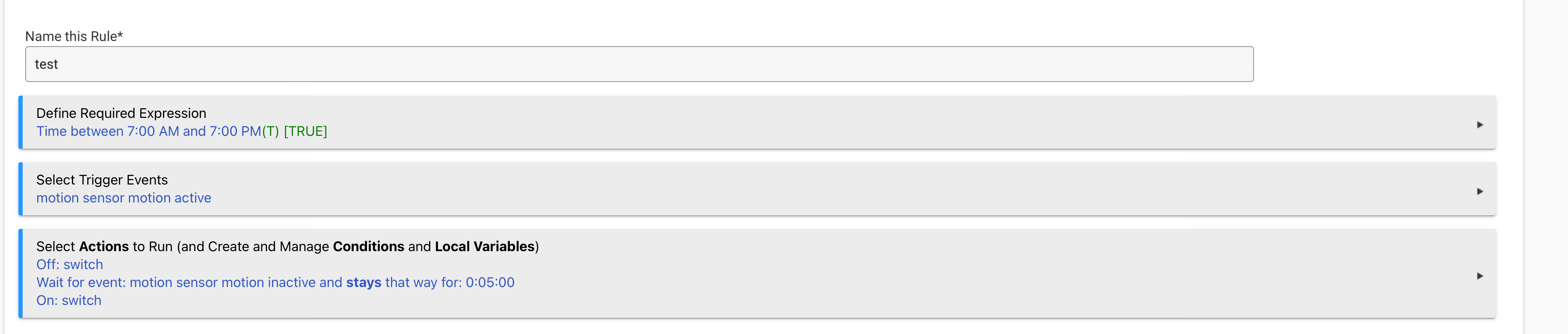

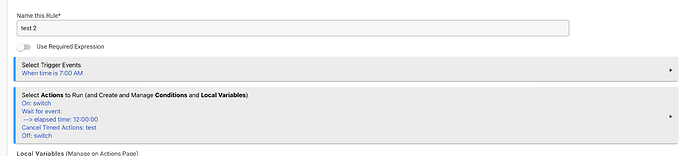

What if you did this with two rules? One just turns the lights on at 7am and off at 7pm, and another turns them off when there's motion and back on when there's no motion for 5 min? Something like this might work. You might need to consider the use case where someone triggered the motion sensor after 6:55pm since they would turn off, the schedule would expire, and they would dutifully turn back on... would take some fiddling I bet to get it to work but maybe the following is a starting point:
Maybe this?
And this?
I've never used the "cancel timed actions" function so not entirely sure it works the way I think it does.

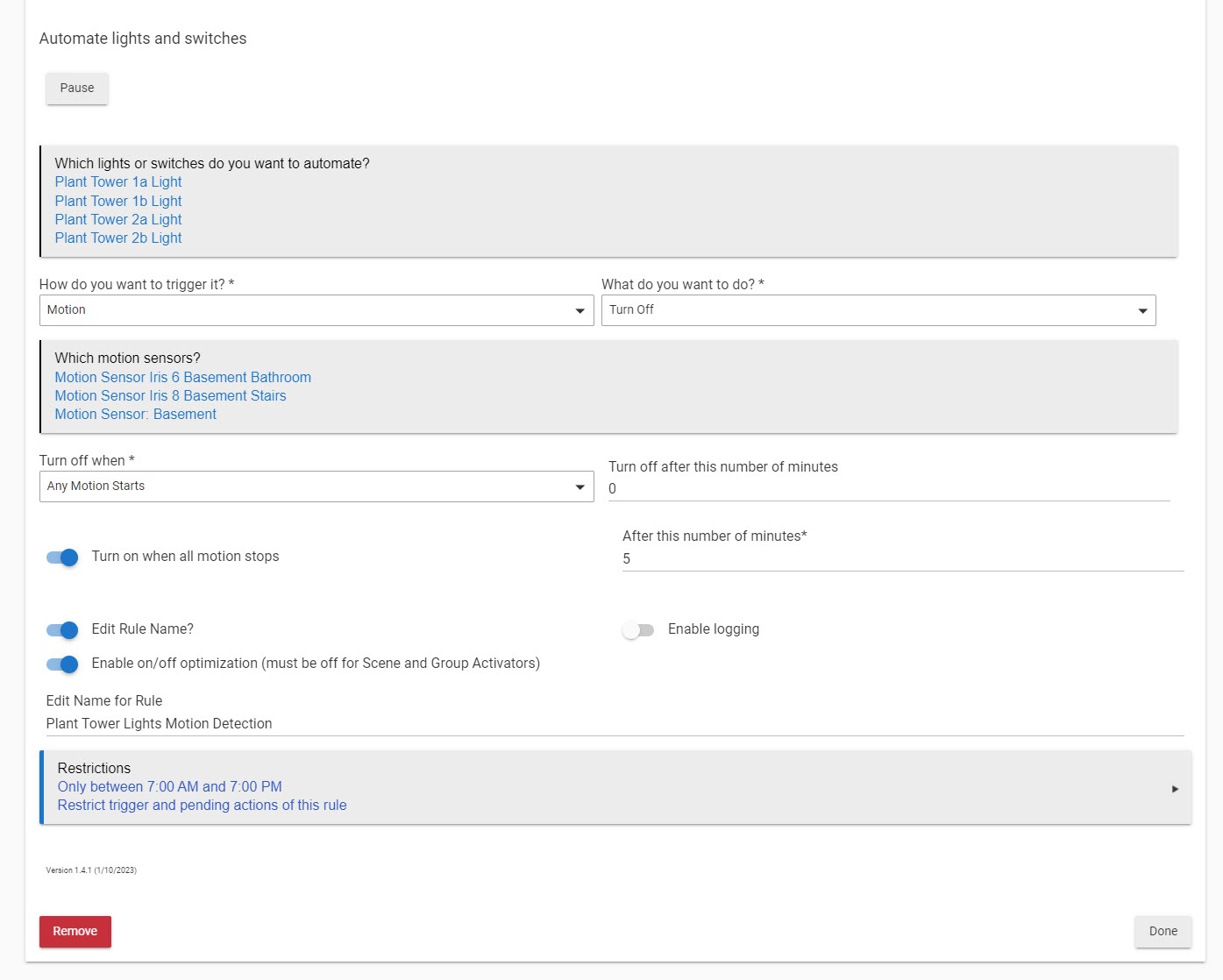

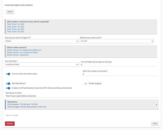

That aside, I've been having some weird issues with Rule Machine and Room Lighting recently. Sometimes things work and other times they don't. I'm finding better luck with Basic Rules and Simple Automation Rules for some odd reason.

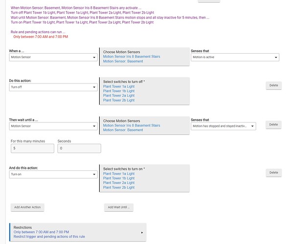

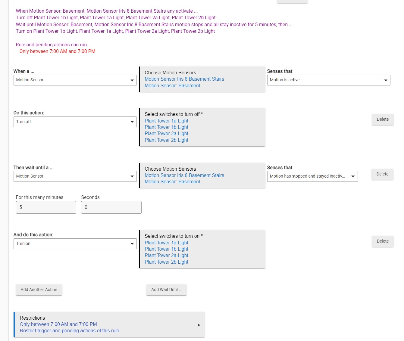

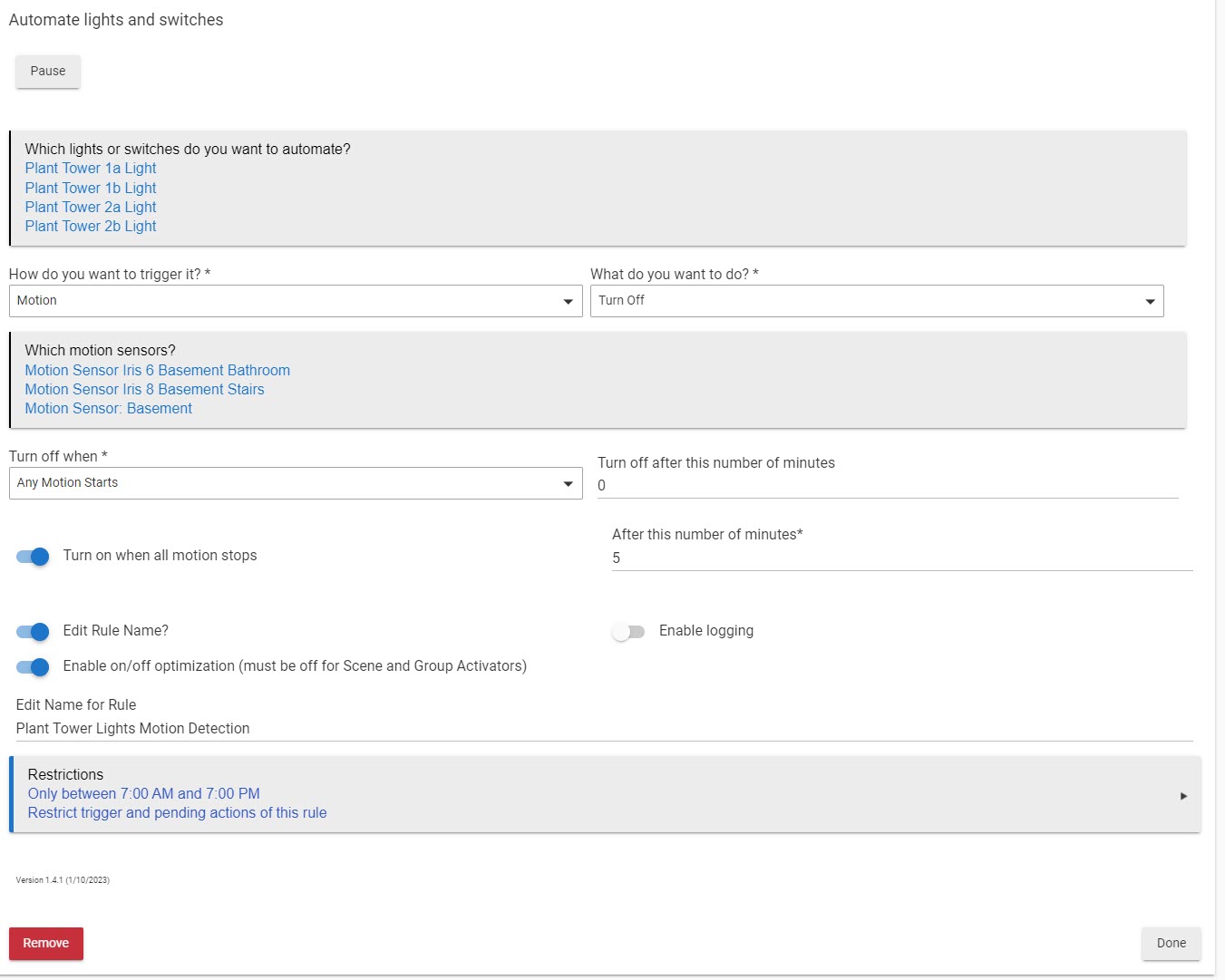

I ended up rewriting everything using two separate Simple Automation Rules and everything seems to be working according to plan:
  1. Trigger lights to come on at 7:00 AM and off at 7:00 PM
  2. Disable lights when motion is detected.
I wrote them like this:
And:
