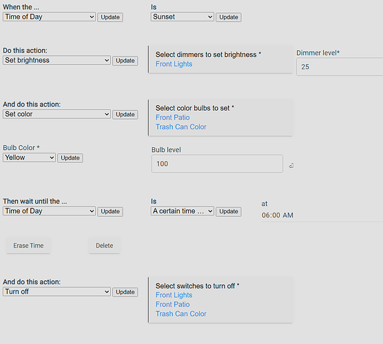

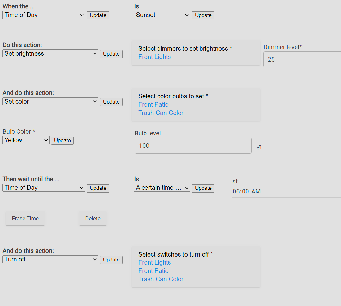

I have a rule that turns on some outside lights at Sunset and turns them off at 6am
One set of lights is controlled by a dimmer switch and the two others are bulbs.
The bulbs work fine but the dimmer will turn on but turns off at midnight . I did notice there was a Z- Wave Poler actiove for it .. I just turned that off.

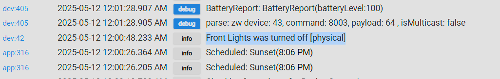

Here is the rule ..and below that is the log that shows it was tunrned off at midnight "Front Lights was turned off [physical]"
Thanks in advance for any guidance

Go to the dimmer's Device page and then to the "In Use By" tab -- is there another rule/automation there that could've perhaps turned it off at midnight?
Are your Alexa "Hunches" disabled? If not, disable that option.
This all assumes no one in your house actually did physically turn off that switch - is that a possibility?
