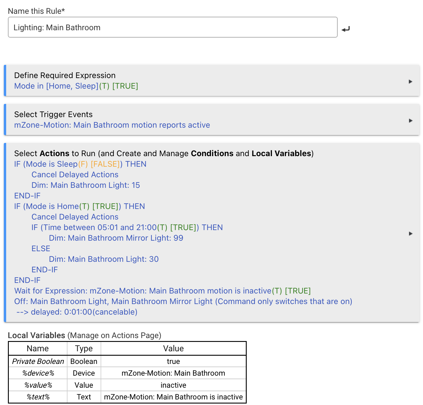

I have a closet light connected to a smart motion sensor.
Right now motion sensor turns the light on at last brightness setting. I’m wanting to do a bit more set the brightness to 30% if in the middle of the night but 100% during the day type setup.
I plan on just tweaking the rule that turns the light on when motion is triggered to include time of day logic, but thought there may be a better way to do this. I want the light to turn on as quickly as possible. Right now the delay between motion and light on is almost zero. Don’t want any logic to cause awkward delays.
Is there a better way to do this or just do it via Rule Machine?
I do this via Rule Machine in a few automations, and there are no delays. Both the dimmers in the example shown below are Zooz dimmers. Here's the rule:
For a single light, this is probably one of the best/simplest ways to do this.
I use modes, variables and RM to do the samething, but i’m keeping all the bulbs in my house at the same temp and brightness across Day/Evening/Night light settings. There are a lot of different yet valid ways to automate something. Yours is perfectly good.
Yeah. Just a single closet light. Nothing connected to the rest of the house lighting.
I’m just sick of walking past the closet in the middle of the light and being blasted with full bright. Hahah
Same here. Once you have Modes setup and working, it really makes it much simpler in most all of the built-in apps to behave differently per mode.
That's how I do it too.
