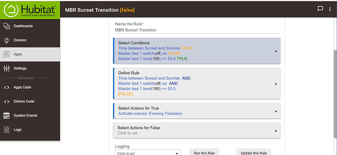

ok, I think I got the rules in place, we'll see how it works. RM4 was not intuitive. I used RM3.
If it does not behave as expected, please post a screenshot of your rule here (just copy and paste directly into the editor to post an image.) This community is eager to assist users in debugging their systems. :slight_smile:
Ok, I had to move my rule to use individual bulbs to get status instead of the Hue groups. The rule is working, but the bulb status as to which the rule is kicked off from doesn't change unless I change the status of the bulb in Hubitat. When I use the zwave wall switch via a rule in hubitat or Hue app, the bulb status doesn't change in the device parameters and the rule engine won't execute the rule.
