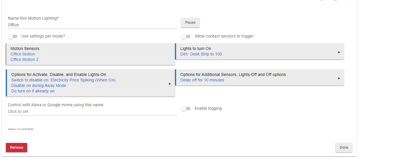

Here's the motion lighting settings:

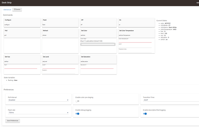

Here's the desk strip device:
set the strip to red in the driver then turn it off.
then activate the motion lighting rule, what color does the strip turn on to?
yep it turned on red.
I think i've had this issue before - i am setting the colors via ifttt not via hubitat and you helped me with ensuring it refreshed to capture the change. perhaps the refresh is not working anymore
edit - poll interval was disabled. i didn't disable it but perhaps it got disabled with an update?
