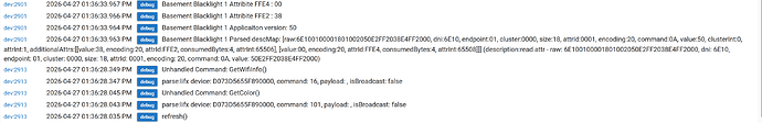

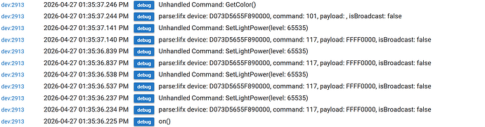

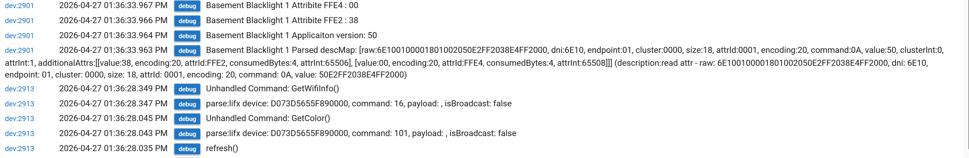

Nope. If I turn on debug logging for either of the two bulbs, I get unhandled command error.

I'm still having that same issue. Lifx app works fine, even after removal Hubitat finds it re add it but cannot control it or get status from it. Feel free to dig into my logs...

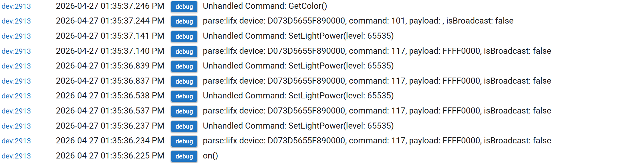

Issued ON command from device page
:thinking:.. Ok Not what I was thinking the problem was..
Going to pull logs..
I'm not seeing anything in the logs.. Will probably need to put something in.. :thinking:
