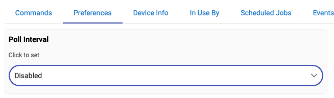

This is expected.. The bulbs don't push changes...
There is a preference on the device page in Hubitat that will poll the bulbs for changes..
Screenshot 2025-11-12 at 1.03.25 PM
Thanks so much!

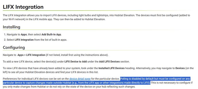

Perhaps the LIFX Integration | Hubitat Documentation could be updated to include that information? Or did I miss it in some other documentation?
Looks like that information is in the documentation - at least it is now!
Yeah, I think they just added it. Wish I had a screenshot so I knew I wasn't crazy.
