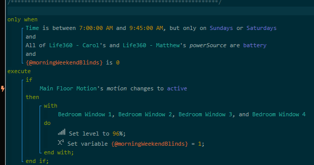

I'm not sure if it's because webcore uses "battery" in its dropdown selections as the comparison instead of "BTRY" (which is what is shown as the device status)
I am having trouble using this as a condition. When both devices are clearly status BTRY, it is showing False on this statement:
4S5gnLE
Your driver is not using the correct definition of the capability, i.e.
powerSource - ENUM ["battery", "dc", "mains", "unknown"]
You might be able to get around it by using an expression.
Thanks!
I was just using the official Life360 one. I edited the driver instead of using an expression :slight_smile:
which driver is this?
Location Tracker User Driver by BPTWorld, came with the Life360 app via the Hubitat Package Manager
