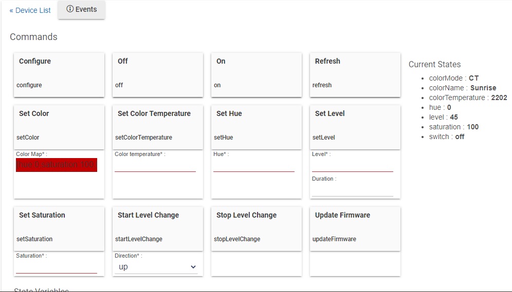

Within Hubitat on the latest build This is what I see when I try to setup any changes, between each stage I dutifully press the button to save the entry.
When I "Save Device" all settings are removed and the red lines appear once more as shown below.

Don’t know this bulb. It’s not listed as compatible. My guess is the bulb color is CIE-XYZ colorspace, and in that case you will not be able to control the color on HE.
[Edit] I just looked it up. This is a color temp bulb. Not a color RGB bulb. Try Generic Zigbee CT Bulb (dev) driver. If that doesn’t work right, try Advanced Zigbee CT Bulb driver.
When changing drivers, be sure to press the Configure button to send the driver parameters to the device.
Thank you, I tried just about every driver, no colour from any of them so I will take this up with Lidl.
Just to be clear, this bulb can only produce variations between warm white and cool white. It cannot produce colours like red, green, etc.
Thank you, it appears they are working as designed :wink:
