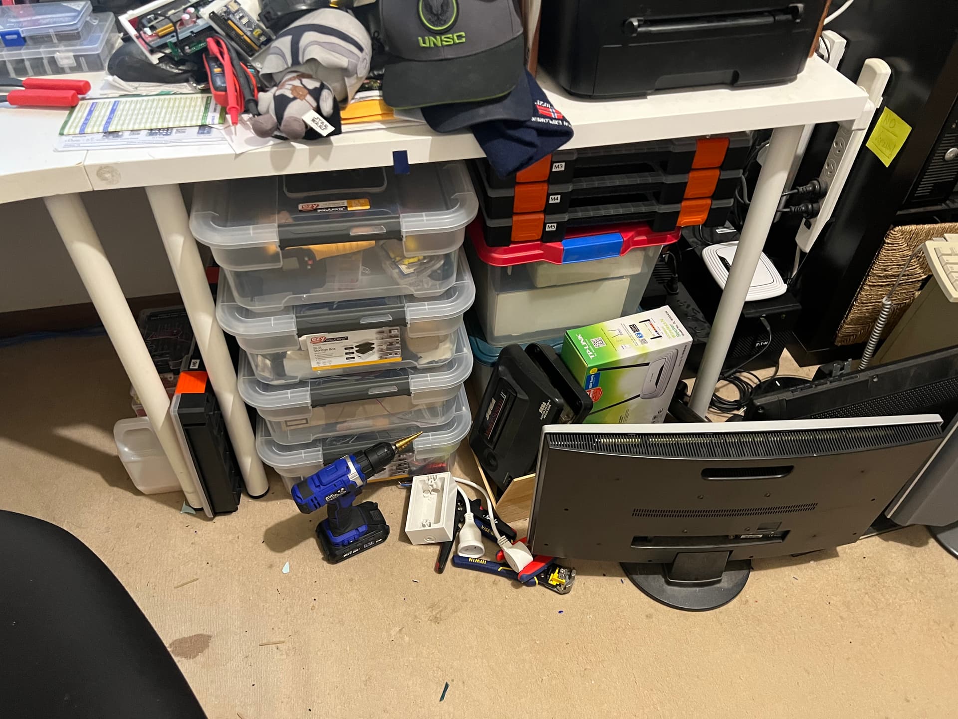

That's what study's are for:
and dont forget spare parts storage: :rofl:

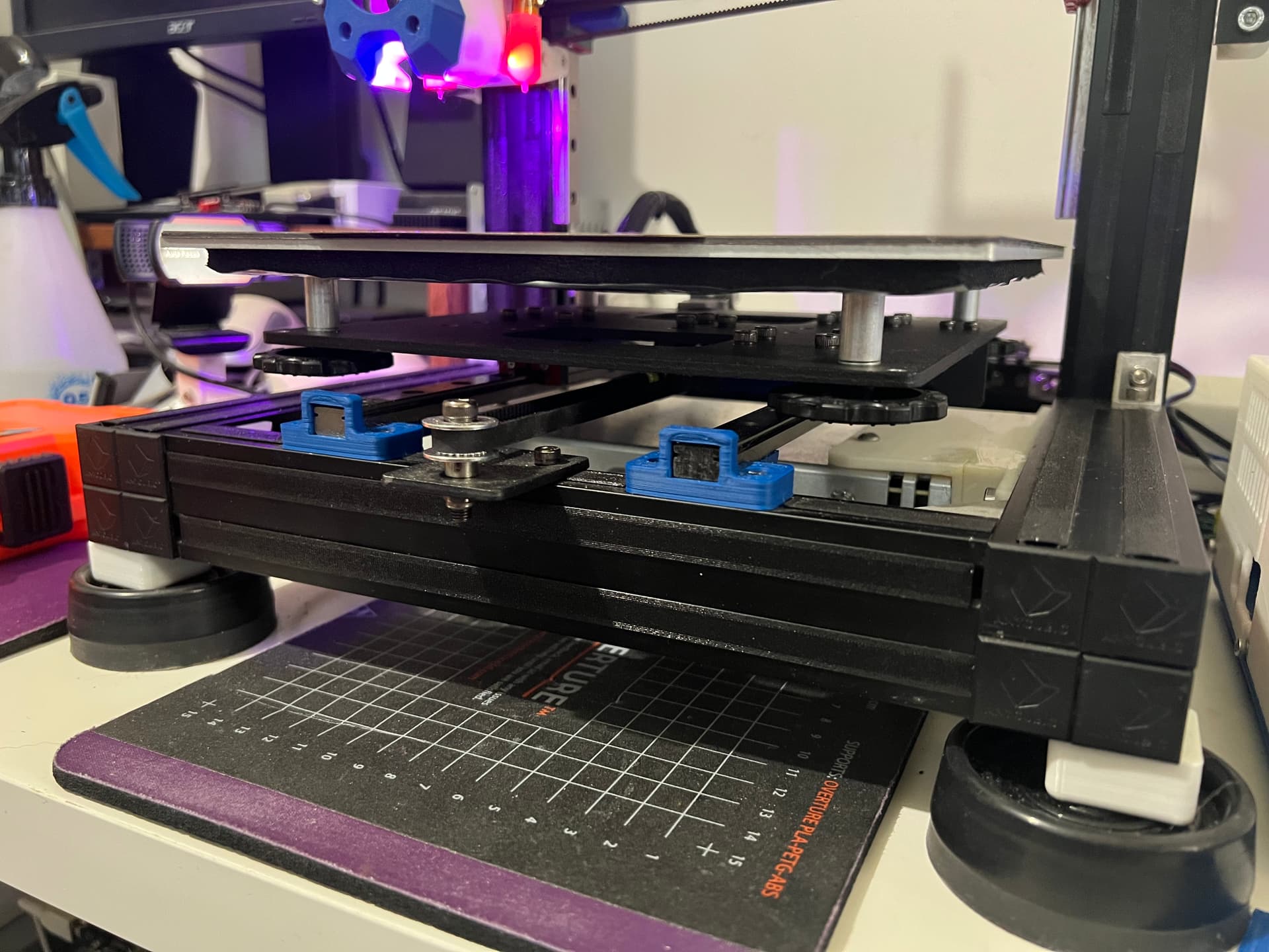

Honestly, I'd just grab some 20 or 25 mm (depending on your current spring height, M4 aluminium spacers and throw your springs in the bin. It is worth measuring the height of them with digital calipers to get them as close to identical heights as you can - You can buy 0.1 mm shims is you need to level the heights out, but after that, you'll never need to level your bed again.
AND ABL will take care of the rest.
Look Ma, no springs!
And that's where you assume much too much. :slight_smile: In the middle of my PETG woes I was messing around w/a lot of things and am not level, last prints showed rear of bed was higher than front (really thin first layers at the back of the plate, closer to normal at the front). ABL before printing was not resolving the difference.
Have not seen that mod discussed before. Just when I thought it was safe for me to be in the same room with my printer... :slight_smile:
Most high end printers with ABL use solid bed mounts. eg most Voron's, Bambu Lab etc. If you are able to get the bed level with solid mounts and shims, it's the best solution.
Bearing in mind that you're levelling the bed wrt the x gantry. So unless the gantry is perfectly aligned with the y plate (along the x axis) you will definitely need to shim it. That said I've been using springs for years and rarely have to realign the bed.
Also the springs serve to provide some give in the unlikely event of a head crash (it's happened to me on occasion) so you have a second or so to react to power the printer off before the head destroys the print surface.

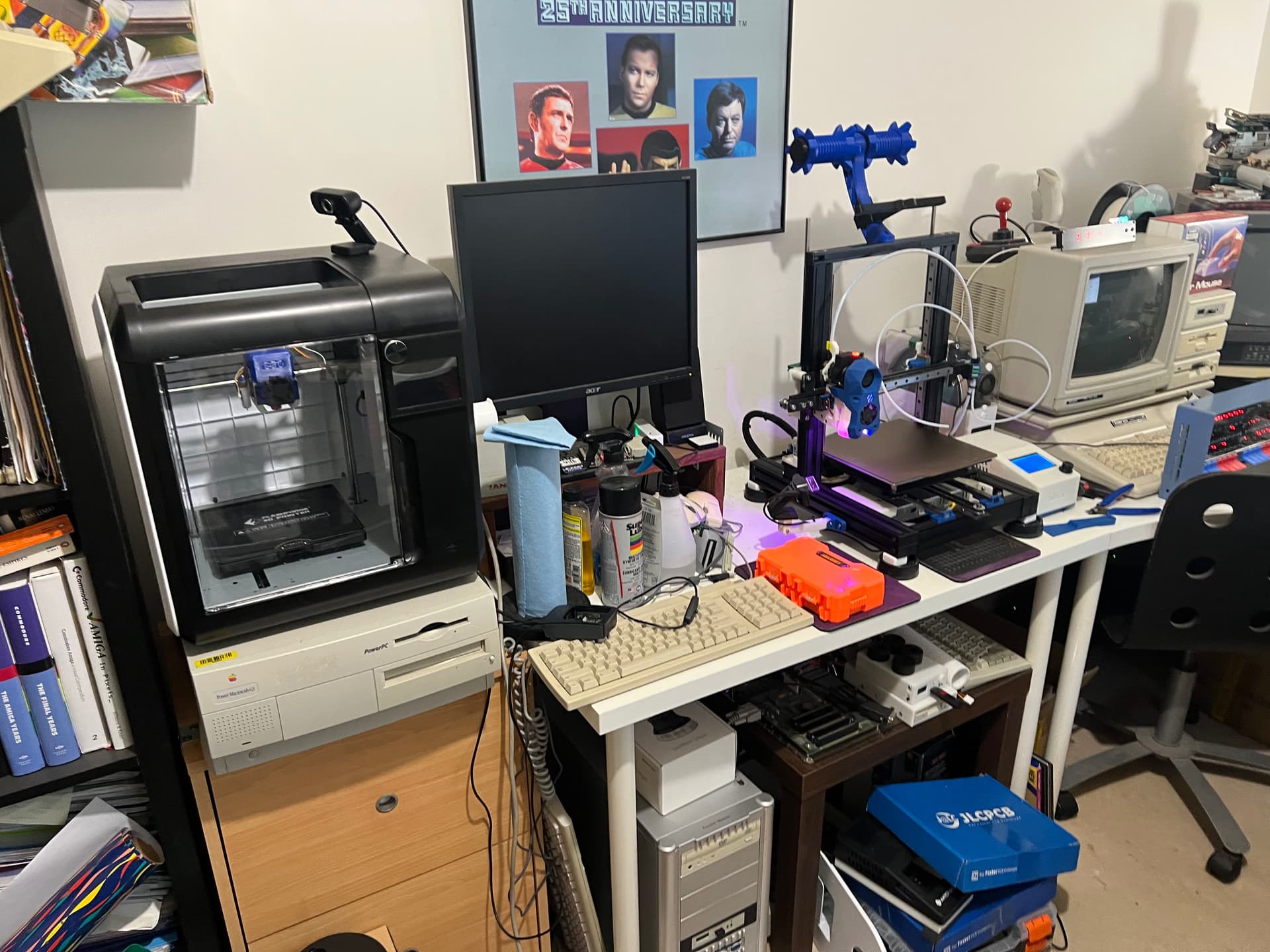

I guess I’m lucky in that I have an unfinished basement with enough room to put it down there. Although time will tell if the table I have down there will be wobble free.

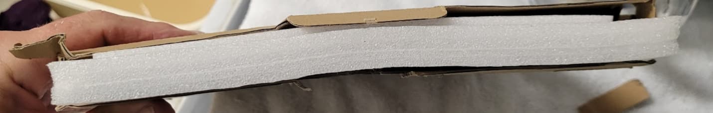

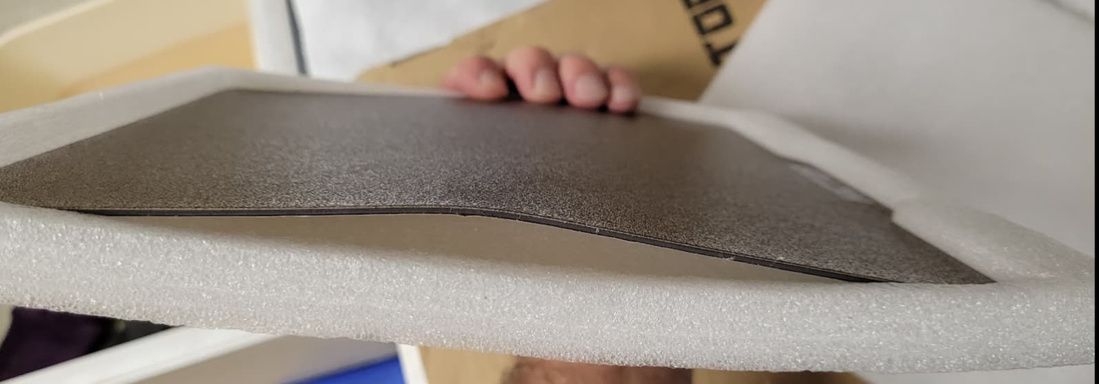

New PEI plate arrived...but plate is really not the word, more bowl...ARGHHHHH!!
It was immediately obvious there were going to be issues...
There she is, my very pretty gold bowl.
Tried to bend it back but it's not willing so far to totally re-adjust to a life as a flat piece of metal. Going to get it replaced. So annoying...
