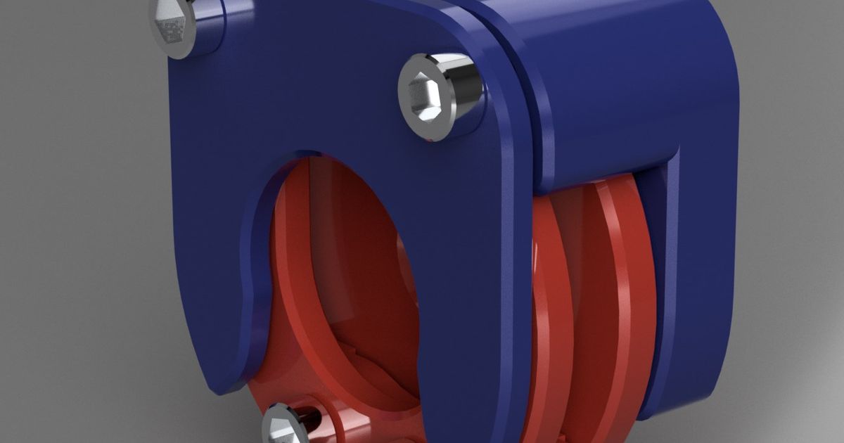

Speaking of lube & oil, I built a precision lube gun per this model:
Syringe pump adapter by flipsht
I used a 3ml syringe with needle. Loaded it with mineral oil. Quirky to load, but it works well for precision oiling. I just ordered a 2nd one.

That’s really clever, I might try it with my solder flux syringes, they look like a similar size.

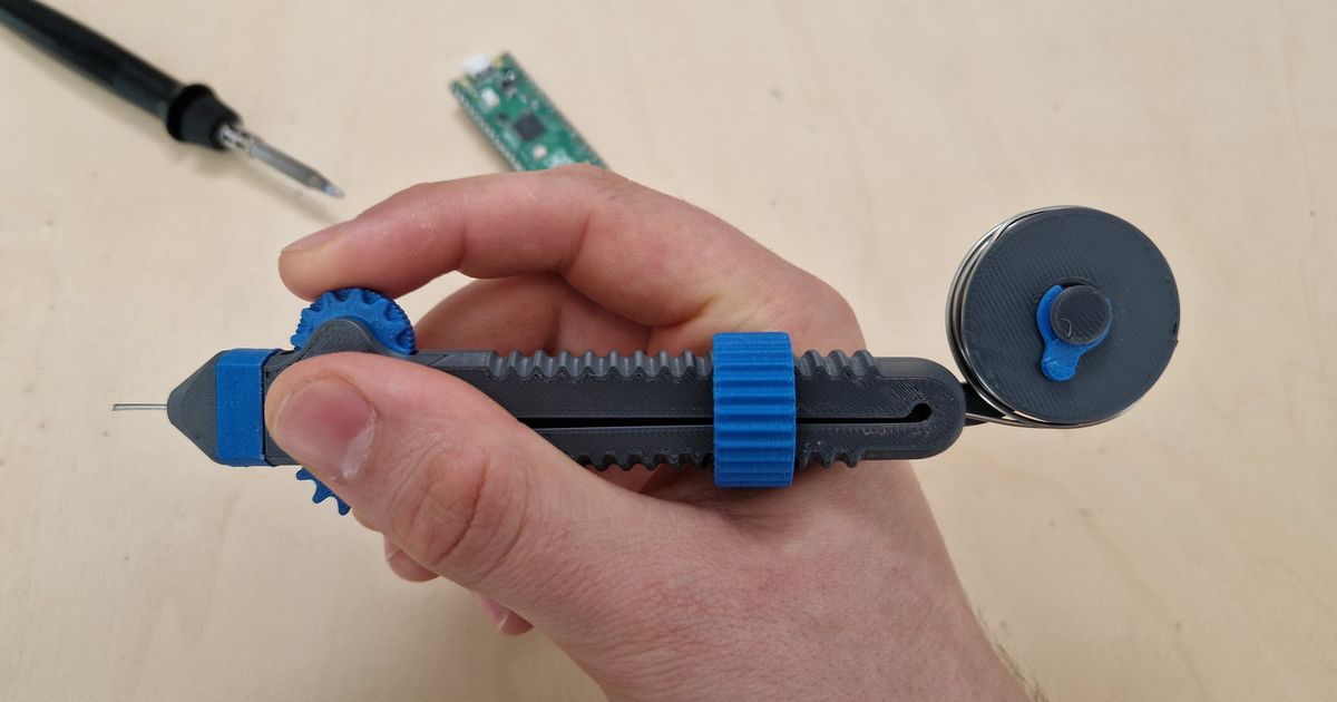

Search yeggie on solder syringe --I saw some good models while digging for that one. There was a solder spool applicator that really caught my eye.

Aahh, I bookmarked it...
Solder Scroll - Adjustable Solder Tool by Victor
