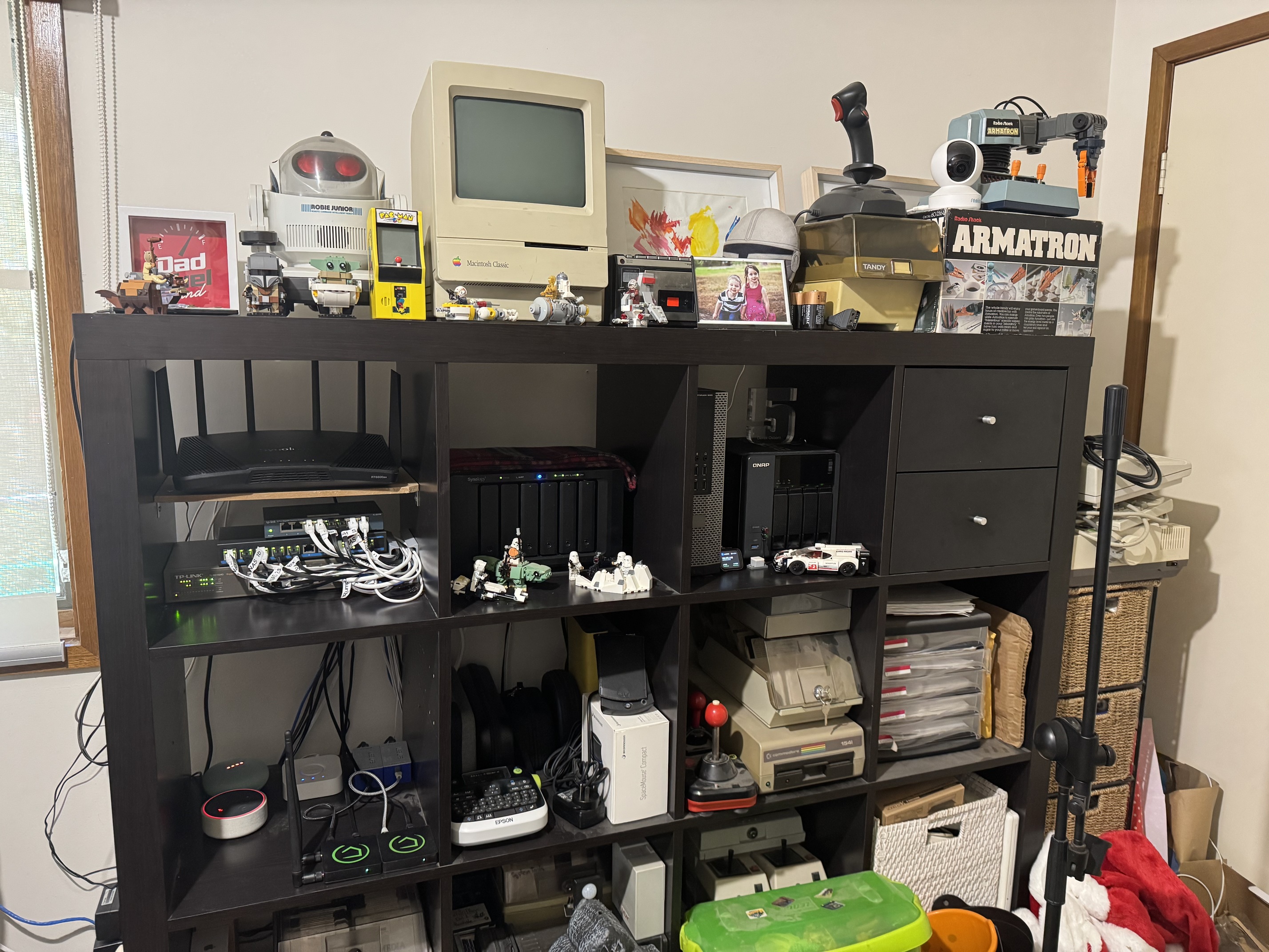

dJOS
January 21, 2025, 8:31pm
2231
That’s awesome! I so need that for my comms gear!
