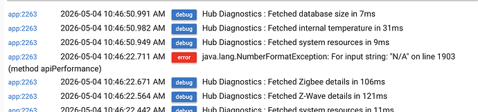

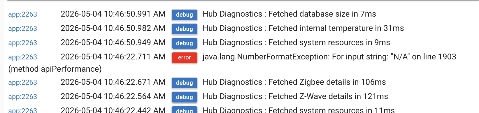

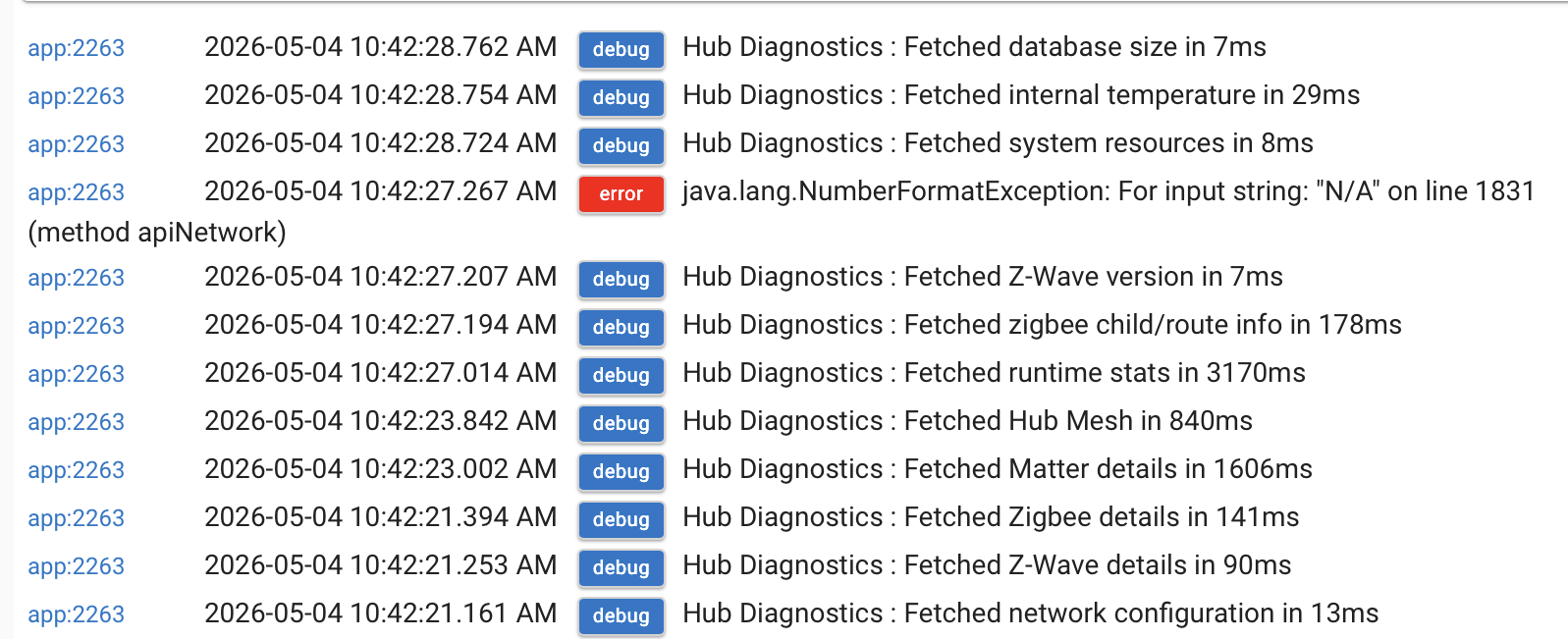

Error on Network on C8pro
Also Performace
@TArman - Are you running ZW-JS
Yep, JS
Hmmm, RouteChanges…. Maybe LR Device shows N/A for this?
Just a guess.
That's the issue.
