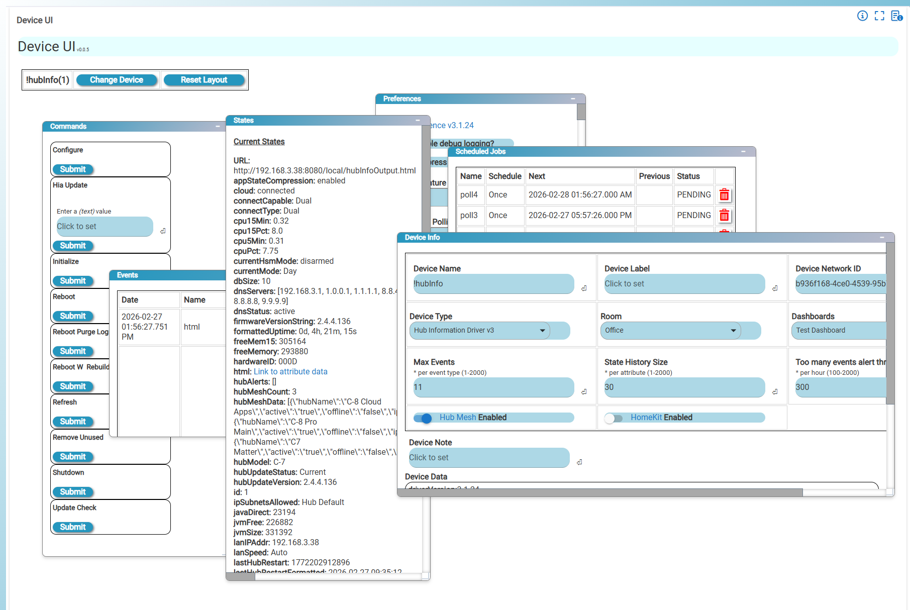

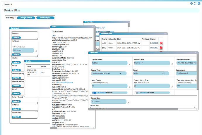

It occurs to me that there are several talented developers in here that all have ideas, some brilliant and some not so much, but all have value and could provoke others into thought/creation. For the last year+ HE staff have put forth several improvements in the UI but I haven't seen a lot of developers throwing what I'd call "fleshed out" examples of what they've comptemplated or tried. So a challenge for any who would like to participate:
As developers we can either go with the default out of the box interface options, or, using the tools that we've been given, develop new ones that may be something that others grab onto and illustrate options that could influence future direction; i.e. stop saying you want a better UI, or process, or... build a model of what you think works better and put it out there for discussion. Doesn't have to be fully functional, just enough to illustrate your idea and spur others to think and comment. (If possible it would be appreciated if comments followed the convention of pointing out the positives of the approach before giving constructive criticism.)
I'll start. A couple weeks ago one of the community was lamenting that the Device UI was too rigid and expressed that he/she disliked the necessity of using tabs to access various elements. This post got me to thinking about alternatives and since I had a little time to play I started digging into posts on CSS, Javascript and HTML and put together a small demo app:
https://raw.githubusercontent.com/thebearmay/hubitat/refs/heads/main/development/deviceUI.groovy
A couple of caveats:
  1. This is late Alpha code designed to illustrate an idea
  2. To speed up the generation of a protype I have hardcoded some items that should be abstracted before publishing a Beta framework
  3. While the prototype target is the device UI (because that is the conversation that got me playing) I'm pretty sure I could develop a similar framework that would allow multiple apps to be presented in similar fashion
  4. UI is not my strong suit :sunglasses:
Highlights:
  • Multiple draggable regions (grab the title bar)
  • Regions are resizable (handle is in the lower right corner of each)
  • Single click collapse/restore
  • Region placement and data is preserved between sessions
  • Works on mobile and desktop
  • Title bar changes color to alert to pending changes that have not been committed
Okay go....
This is complex. So, must have taken you an extra 5 minutes to throw it together?!? :wink: Sorry, I didn't mean to insult your abilities. 4 minutes?
:joy: Took me a little longer than I thought it should (actual working time is around 40-50 hours but I haven't been in my home office a lot the last 2-3 weeks), and it still needs some work before it's production ready, but I've enjoyed the learning experience. If we decide it's something worth pursuing as a model I would want to convert the generic elements to a library (it's almost there) and provide some simple methods to instantiate the regions.
Very nice. First thought that comes to mind: a "maximize" button next to the "minimize" on each region; be especially nice for a quick zoom-out on "wide" regions like Events and Scheduled Jobs.
Also: the "switch" for Hub Info isn't working exactly right.
Not a bad idea...
Can you elaborate on this?
On the device I tried it on, Hub Mesh was enabled, and said "Enabled", but the visible switch was off. Clicking the switch moved the switch, but never changed the "Enabled" label; I'm not sure whether or not it was actually changing the Hub Mesh state.
I'll check into that, switch should reflect the state - verbiage is from the original device interface.
