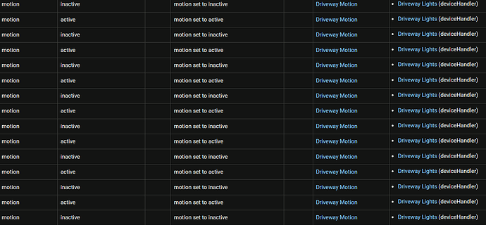

The battery is 94% now and I'm getting lots of false alerts.

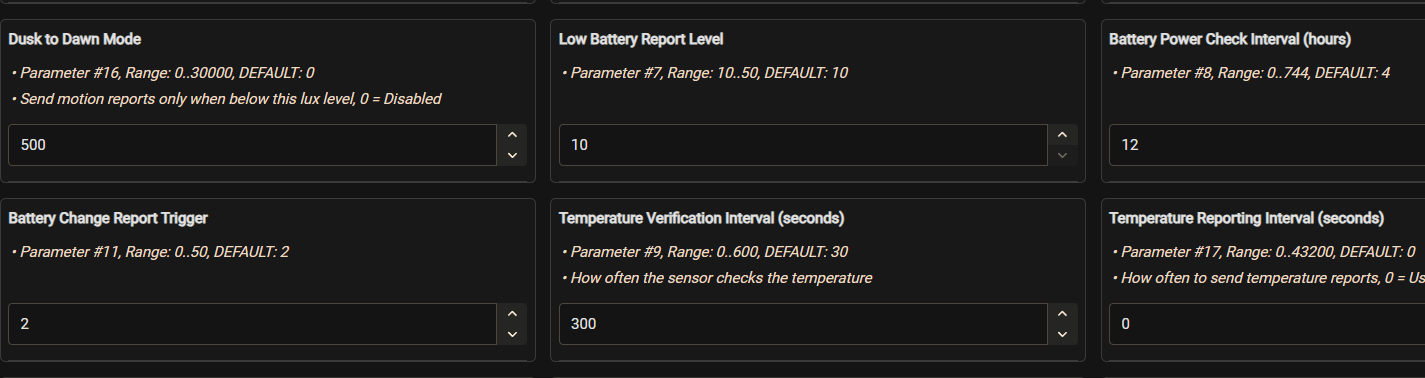

I have the Dusk to Dawn is set to 500 so it shouldn't report in the dark.
It is dark out and no one is in the driveway but the events come in rapid succession sometimes.

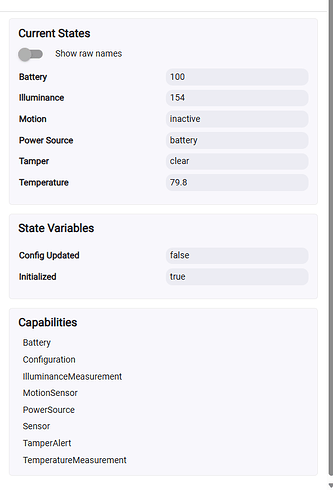

Just letting you know I have 2 running on batteries and both started doing what yours did and I just remembered this thread. Battery is 100. I had recently changed to ZWJS and updated the firmware from 1.2 to 1.3 and that seemed to have started this. [probably coincidental]. 1st one that started I finally replaced with a spare. After messing with the 2nd yesterday I replaced it with the one that I changed out earlier [had factory reset after excluding} and it drove me nuts all night. Alexa announces it. Seems to have calmed down now. Not sure why, changed to system driver and got rid of 2 tiny wasp nest that had only 2 wasp apiece and were not that close to it. Just reporting for the record.
