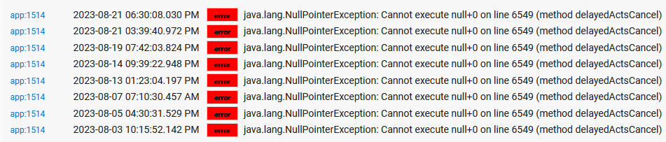

I have three Legacy Rules that monitor doors being left open. They have not been modified in years but are throwing errors. I don't know exactly when the errors began (because they only occur when a door is actually left open and Logs have a finite retention period) but my intuitive is a hub update is the cause. I'm currently running v2.3.5.152 on a C-7.

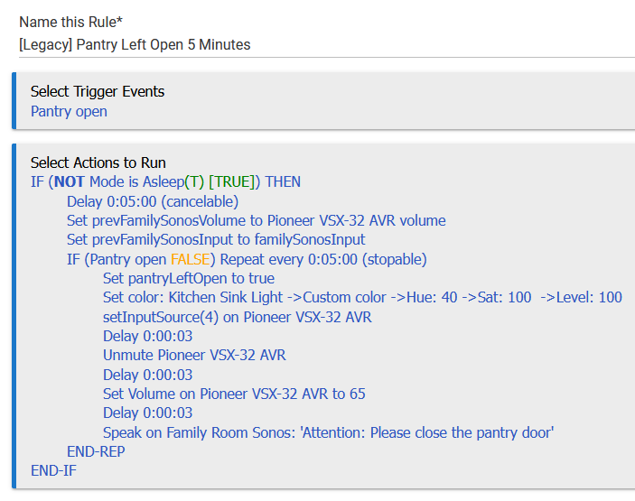

This is one of the 'door left open' Rules:

I just noticed a potential issue:
Where is the Conditional with repeat in the Legacy RM UI?
Should be the same way as it was set up before, a simple conditional (not a full "if expression then") with a repeat chosen as the action.
But on a related note, there are now more ways to create repeats, including "while," so you may be able to find a different/better way. I'm not sure how this one is stopped (that appears to be broken in your screenshot, perhaps a deleted device or variable), but they are a newer option.

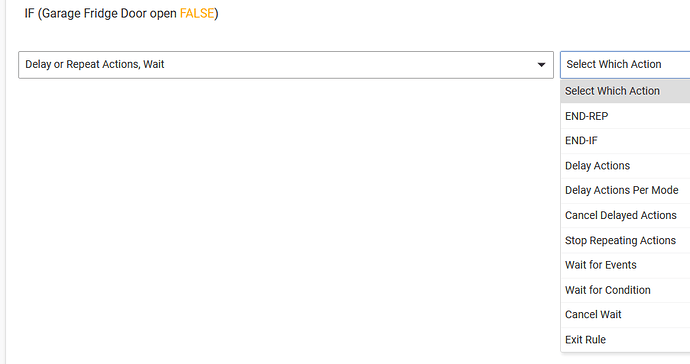

Okay, selected 'Simple Conditional Action' and then 'Delay or Repeat Actions, Wait' but I don't see an option to Repeat Actions:
Can you change your Delays to Waits and see if it works? Also, you're setting a lot of things within the repeat that probably only need to be set once - unless you have conflicting rules that'll change the sink light or the AVR. Perhaps that'll help eliminate or combine some Delays/Waits.
I think that means you have a repeat action already and it won't allow you to put a repeat within a repeat. If it's still there, delete the broke repeat first.

It erroring on the Simple Conditional with repeat:
I'll delete that action and recreate it.
I don't think you need to check if the pantry is open to start the repeat. You've already established that the pantry is open when the rule was triggered. If it's closed then your second rule will stop this rule from running. Try the repeat without the simple condition and see if it works.
