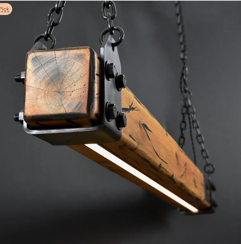

I am making a "Beam Light" similar to the one pictured below. Mine however, is going to be somewhere between 20 - 24ft long. This is going to be outside up under a deck with a roof. I want to place LED Strip lighting on both the top and the bottom sides of the beam that I can control separately. On the bottom I want the LED strip to run in one solid run with a few inches on the sides for support brackets. On the top I expect to use a couple of separate strips leaving some gaps so I can mortise in holes for the LED controller(s) and anything else that I need to hide.

PS - I really like the look of this project overall (your included photo), so sorry I don't have any great LED controller suggestions.
