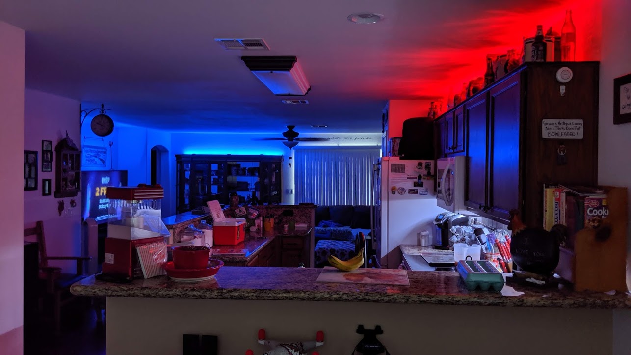

I purchased the OSRAM Lightify strips for the over the cabinets under the cabinets in the kitchen, wall unit, TV. They come with their own powersupply, zigbee box and pair up instantly to HE. They have 3 strips about 24" for each one so you have the ability to use all of them or only 1 or 2 if needed and you can adjust the brightness, hue, saturation. The picture shows the color strips setting about 85 and the under cabinet white strip is 45 for brightness.
