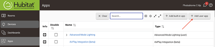

So.. how do I use it? I imported the code into a new app, but I don’t have a new app show up.. what am I doing wrong?
You still need to add it in the Apps tab.
It will need a couple of small changes to select the device and send the correct event.
